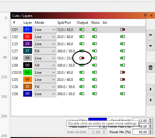

In the cuts & layers window you can turn off the output of any layer that you don’t want cut or engraved.
cuts & layers
In LightBurn yes, I know about that. I was specifically asking about on the Ruida controller where the job is stored.
