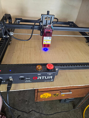

Need help! Just moved had my ortur laser master 2 pro working fine before the move. Got it set back up and now on all of my programs my origin point no mater weather in user origin, absolute, or current position, is now in the middle of my workspace. It will not clear the origin or accept a new origin. I need this fixed as I am losing half of my workspace. I have moved it home then used the move menu to get just off of the home position then when I hit set origin it does not zero the x and y axis. Then when told to go to origin it goes right back to the center of the work space.
If it helps I have my origin corner as front left and when I home the laser it reads x=-2.775 and y= -2.869.

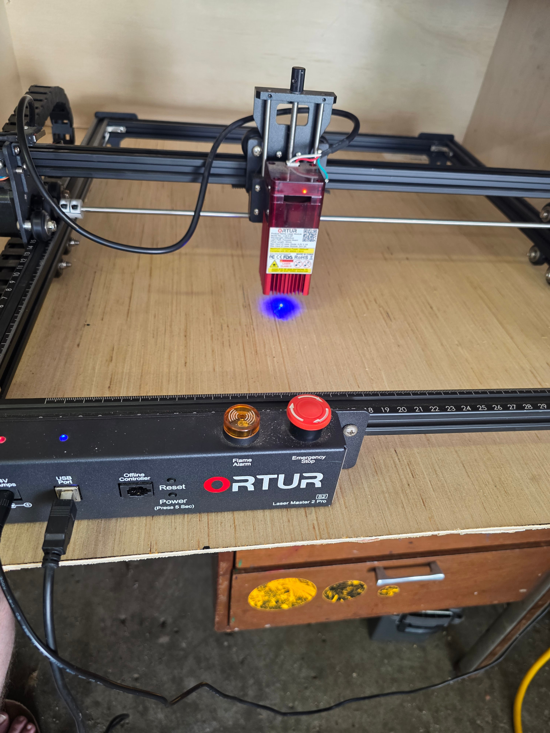

Sorry for the wait i was out of town yesterday. When running the file you sent me this is where it the pattern at.
That looks like more than 2" from the Home position. Are you sure [1] Absolute Coords are selected and [2] you you have not clicked on the Set Origin button at any time?
This bothers me, and might explain why your module appears to be 4" off in both directions with the test program. Once I get your answers to the last questions, we can try something that might solve your issue.
