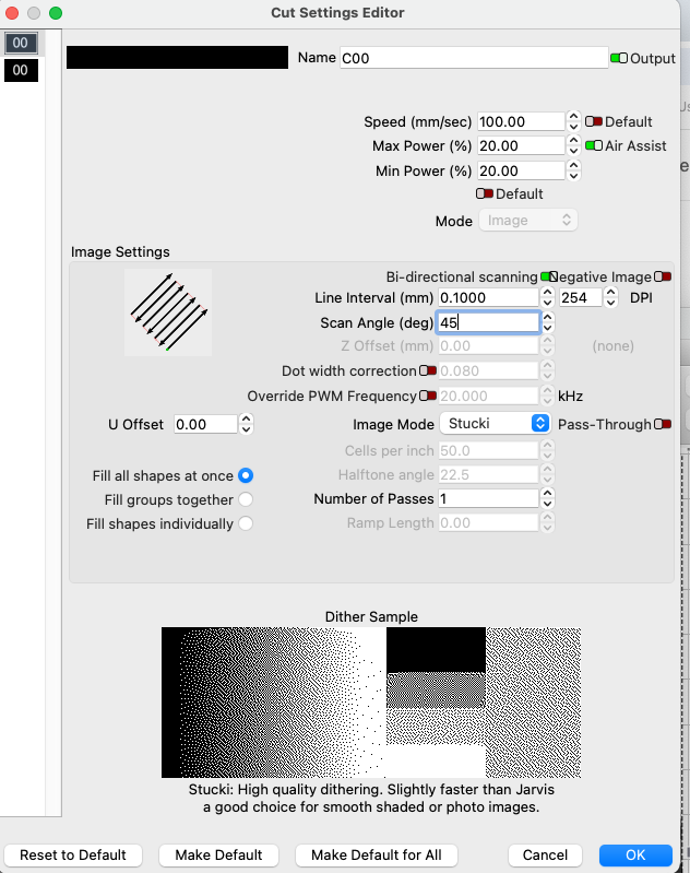

why does the software not let you change the scan angle for images? it only allows 0 degree.
It does.
i forgot to mention with pass-through enabled.
also the min.power is grayed out and not ajustable.
See this post:
‘Min Power %’ for a diode laser is only available when you use the Grayscale image mode where power is always ranging between min and max, but for dithered images such as you would use for Pass-Through, the power is just either completely off or fully on at the ‘Max Power %’ setting.
