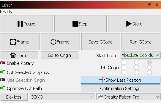

I think I’ve read most everything here in the forum and searched for solutions online . . . but I just cannot get Lightburn to connect or synch with my Creality Falcon 10W.
I’ve tried:
  1. Find the device
  2. Importing the CR Falcon .lbdev file.
  3. Manual setup of the various GRBL devices.
  4. Rebooting Creality Falcon.
  5. Rebooting computer.
  6. Remove USB cable at the laser and at the computer (not using any USB hubs, but straight into the MB), trying new USB cable . . .
  7. Different COM ports (if they appear, usually COM 1 and COM 3 . . . on one COM, LB reads “Ready” (but no response to LB move commands), and the other says “Disconnected.”
It appears to me that other Creality Falcon 10W owners have been frustrated with this as well, but I haven’t found any solutions.
Help would be greatly appreciated.
Assuming Windows machine. Has it ever worked or is this a new installation? Did you install the CH340/341 driver? Does the computer make the connection sound when you plug in the laser?
Open the Windows device manager. Which COM port is assigned to the laser? It should be listed as “usbserial” device.

Start with installing the driver. Windows needs it to see your laser, otherwise it’s an unknown device. You can download the driver from this page, yes it’s Xtool, but the driver is generic. CH340 Driver Installation Guide - xTool Support Center

I would unplug the USB Cable from the computer, install the driver, then drag and drop the lbdev file onto the Lightburn workspace. It will automatically bring up the install dialog. Once that’s done reconnect the laser and see if it is located.
At first, as in the above screen shot, it said “Ready,” but the laser did not respond to any Move commands, e.g. Home or set laser position.
Then, I unplugged the USB cable and replugged it, changed from COM1 (which said “Ready”) to COM3 (which at first said “Disconnected,” but then said “Ready”) and now it seems to be responding to Move commands.
Crossing my fingers and proceeding from here. Thanks for your help. I’m not sure I understand what just happened entirely, but I think it might work

The ready message in the laser panel is confusing. I wish it wasn’t there. It says ready even if there is nothing connected. You need to go to the console window and look for activity there to ensure you have connection. I don’t have a laser connected to this machine and the console window says waiting for connection. Once I connect it to a laser it provides firmware info and some other info and finishes with a connected message.

Rather than disconnecting the cable for the diode try this. Open the drop down menu next to the devices button ans select the proper port for the Diode or right click on the devices button, that should reset the connection without disconnecting. One of those methods should result in a connection.
