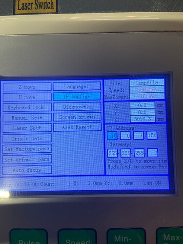

I hooked a rj45 cable direct from MacBook to the Ruida Controller in the OmTech ( I did not know about altering the MacBook ethernet port). Needless to say it didn’t change the connection issue. I reconnected the MacBook and OmTech to the network, and pinged the connection. Here is the screenshot of the results.
Screenshot ping 10.0.1.150
Here is screenshot of Ruida Console with IP address .

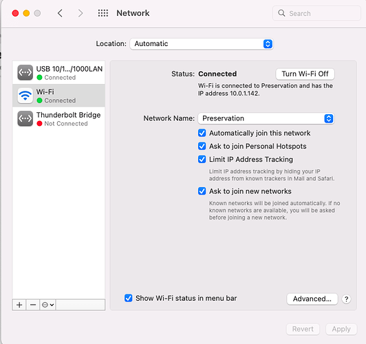

Here is screenshot of MacBook ethernet screen.
MacBook is also on WiFi, here is the screenshot.

Is your whole network domain 10.0.1.xxx? This is not common, but it should work.
I stated that the Ruida is static you have it set for a dynamic ip…?

Most routers create a user domain of 192.168.1.xxx from the vendor. Unless you changed that, it’s probably your problem connecting. There is no fixed address domains, only suggested ones.
When a device first connects to a domain, it asks (via a message to a network address of 255.255.255.255), the DHCP server that it’s requesting an IP for it to use on that network. The router usually has DHCP software on board to issue addresses.
The Ruida has it’s address set, via the front console (Z/U → IP address, I think). It does not ask for an address, it uses it’s pre-programmed IP. This can be a problem if your DHCP server doesn’t know it’s static. On my Linksys router, I can see it on the Lan network map, click on it and I can tell the linksys that it’s static.
Look at the devices on your network and see if they are in a different domain. It sounds like someone has changed it… usually they are 10.0.3.3
Change it to something not in your network and google your router on how to set that address as static or bind it to the Ruida MAC address.

Thank you for responding, whoever you work for, you’re still willing to help me out!.. Doesn’t make a lot of sense to an old hammer mechanic such as I… but I’ll study it a bit and see what I can see. My MacBook IP address is 10.0.1.158 and works great on the network… I’ll google my router info, and look at my domain name on my iMac too. What confounds me is it all was working before seasonal hiatus and software updates.

Since this occurred during a time out, it might be that your router issued a duplicate IP to another device.
Sounds like your domain is 10.0.1.xxx so the Ruida should be there. The only thing I can think of is what I mentioned.
In your browser, can you see the laser via your router setup? If you unplug it does it go away?
If it’s on your network, and you haven’t dealt with it being a static device, then I’d fix that first.

I can see it at the 150 address in your arp -a scan.
As far as I know, Lightburn doesn’t interface directly to the Ethernet hardware port, it’s handled by the os, and the Ruida seems to answer the arp -a request.
Did you unplug it and ensure that address goes away? Just making sure you are seeing the Ruida and not some other device that has been assigned the same address.
Just unplugged ethernet cable for OmTech, ran arp -a, here are the results…
Screen Shot 2023-10-10 at 13.45.14
.150 shows up twice, ?? maybe if I assign the Ruida controller a new IP address it would work, I’ll try it
Jack, you’re a genius… I changed the IP for the Ruida, and manually updated the Lightburn devices and Eureka, OmTech says “Ready”. I’ll give things a try now…
