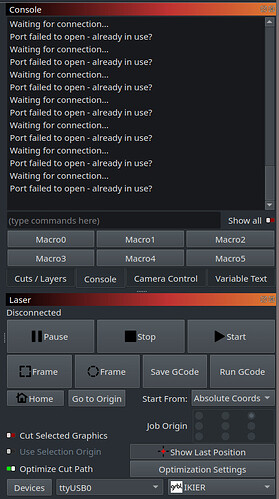

I am having issues with connecting to Lightburn 1.7.08 in Manjaro Linux running kernel 6.12.20-2.

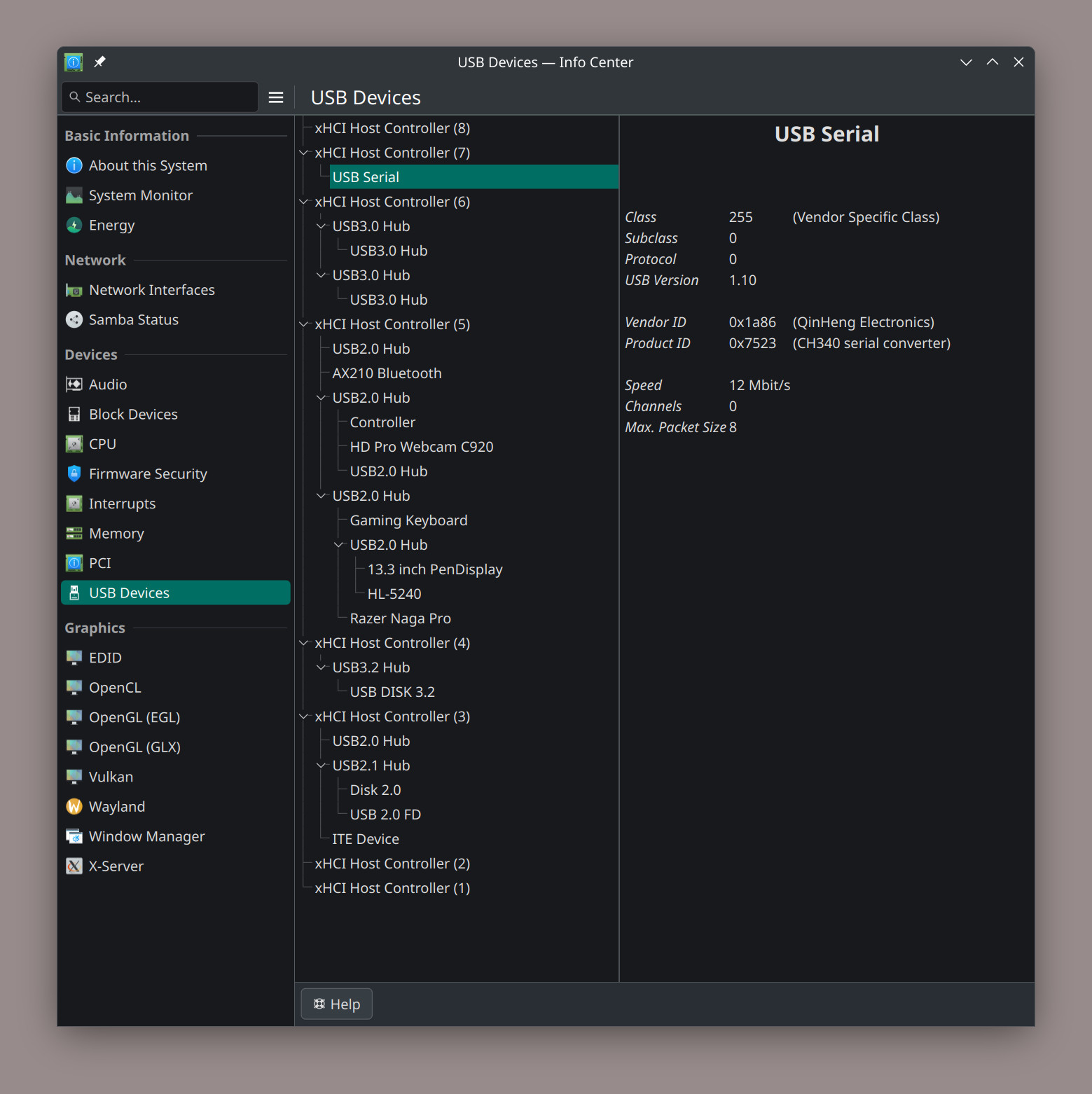

The green highlighted “USB Serial” device goes away when I unplug the laser as does the ttyUSB0 port in Lightburn. So it looks like it’s being polled by the software and the correct port is selected. When I reselect in Lightburn I get “Port failed to open - already in use?” error. I’m just not sure where the disconnect might be.

Used lsusb to check the controller displayed as QinHeng Electronics CH-340 usb-serial adapter
