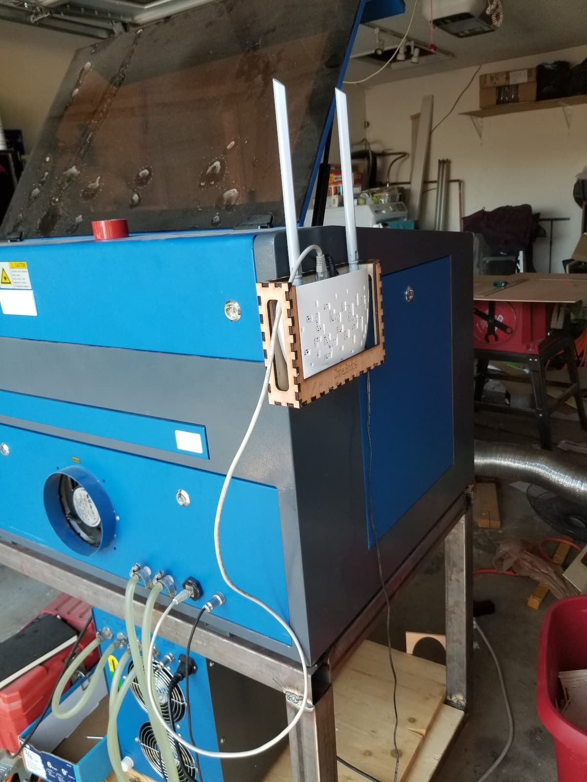

I use an Amazon wifi bridge with the Ruida plugged directly into it.

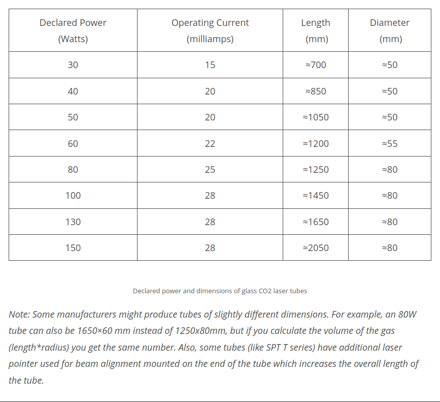

I do have a quick question about laser power though. This is a 45w CO2 laser. I believe there are controller settings which specify how strong the laser should be commanded to run? How can I best figure those values out, to tune the laser such that there’s no chance he cranks the power too high and burns it out? Is that even a possibility? We ran the laser on 30% and the wood turned pretty dark. It was moving slow but I’m just a little worried setting it to 100% power might cause issues.

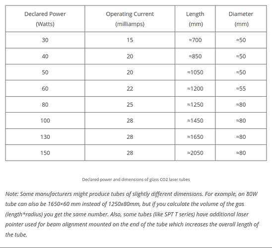

I’ve found this table to be a good reference.
Base it on the tube length, not what the supplier states… it should be close. My 50W from OMTech was 880mm in length and generated 43W. About right considering a 40W tube is ~850mm.

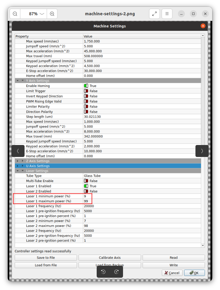

You can set the pwm upper/lower limits within the Ruida.
Mine won’t lase below about 9%, but I have a 45W tube, I’d like to be able to use it, so the upper limit is 99%… Never checked the controllers output at 99%…?
