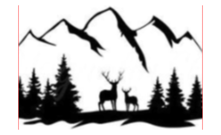

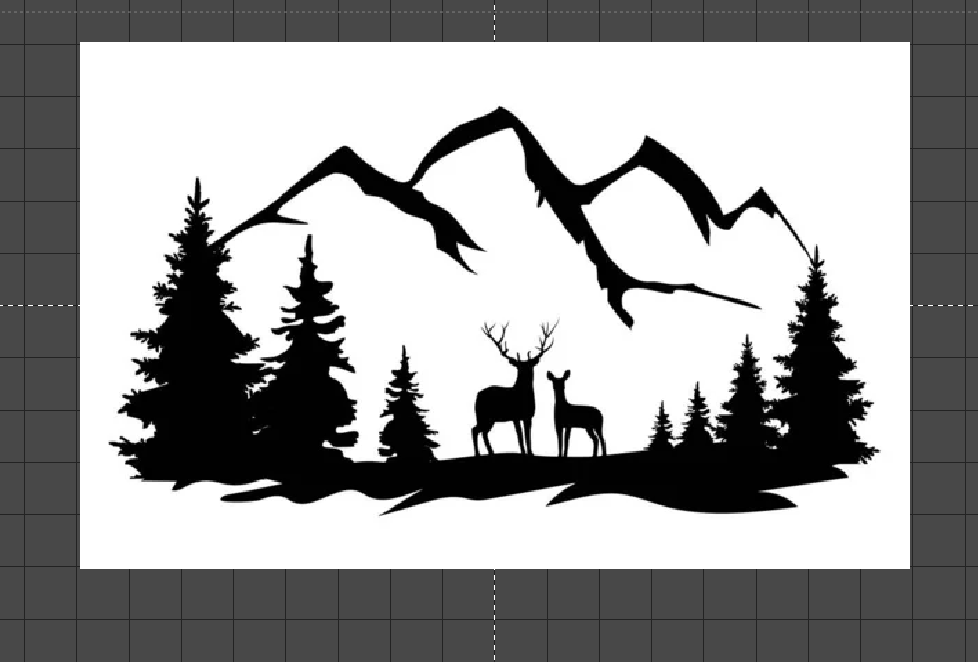

I’m looking to create a sign burned into wood. I have lettering that surrounds the top part of the image. There are two vertical lines on each side of the image that I cannot remove. See image:
I have used several third-party software packages in order to remove the border. Below is the image printed from MS Windows:
Windows Image
I reviewed the Forum posts and have tried to remove the lines using Trace, then tried to remove the lines. I cannot click on the lines to remove. I verified that the image was Un-Grouped.

Use the TRACE command to change from an image to SVG object.
Then use edit nodes to removed artifacts.
-OR-
—> Without changing the IMAGE to SVG<—
Use the MASK command to remove the white areas around the image and the red lines

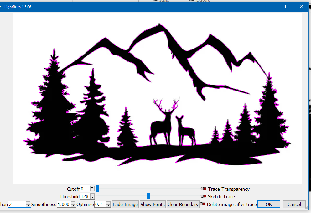

Sometimes it is easier to find another source file that does not have issues to work with. Try right click on the image below, copy to clipboard and paste into lightburn.
This is the upload button to send files to the forum.
This is a similar JPG that I will show you how to TRACE
Right click to copy to clipboard
CTRL+V to paste into lightburn
Right click on image to open menu. Select TRACE command
Play with the sliders to adjust the quality
Press OK and you now have an image and an object
If you traced and then ungrouped, I suspect that you have the image and vector overlayed on each other.
Click and drag to see if you have one over the other.

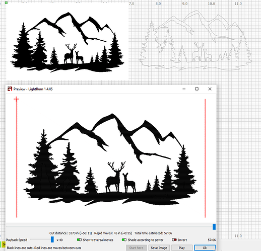

I followed your instructions using the provided image and here is what I get:
I would delete the one on the left to avoid confusion then select and preview the one on the right.

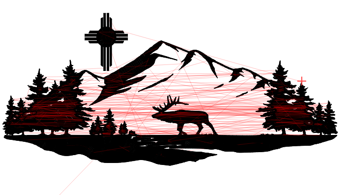

I tend to work in FILL mode for all of my layers due to the visual clarity it offers. The red lines on your IMAGE preview is because you have SHOW TRAVERSAL MOVES enabled and you have a slight overscan enabled. That shows where the laser head moves but does not burn. Were you to increase the overscan, those red lines would be a lot wider.
If it’s the red vertical lines (green arrows), that’s from having show traversal moves enabled in the preview. In this case, it’s your overscan.
@JimNM – missed you comment oops.
Curious. Why does it not look like this?
You don’t have FLOOD FILL or OFFSET FILL enabled. The laser head will travel from edge to edge and engrave line by line.
Try FLOOD and OFFSET and look at the previews. Push the PLAY button to see the process the laser head will follow to engrave.

Hello Jack,
Thank you for your help. This is one of those DUGH moments. IO turned off “show transverse moves” and the lines are gone.
Thank you again,
Bill
Hello James,
Thank you for your help. Turning off that option gives me the image I’m looking for.
