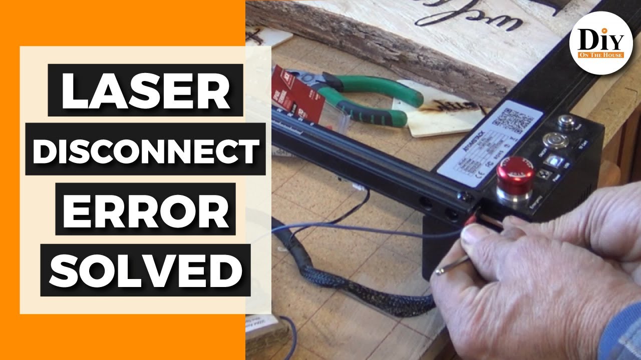

The issue was grounding. All other programs worked with no issues. I had to install an extra ground wire for Lightburn to control the machine. I know there seems to be no logic to that, but another forum suggested it because other people have the same issue on their machine when trying to use Lightburn. I just had to install an extra ground wire.
Go into more detail please. You installed a ground wire where?
If it was from your computer chassis to your laser chassis, that makes me think that your USB Cable is not properly shielded, or one of the ports is not properly grounded / connected to the machine or cable. I believe the shielding on the cable should be grounded to the chassis when connected to the port.
Here is an example of what I did. I still do not know why this was only needed for Lightburn to work. All other programs worked fine.
That makes sense as far as static buildup or other issues with the laser itself, causing a job to fail like they were dealing with.
It should have no effect on initial connection with your computer though. I don’t understand it either, but at least you’re working now.
