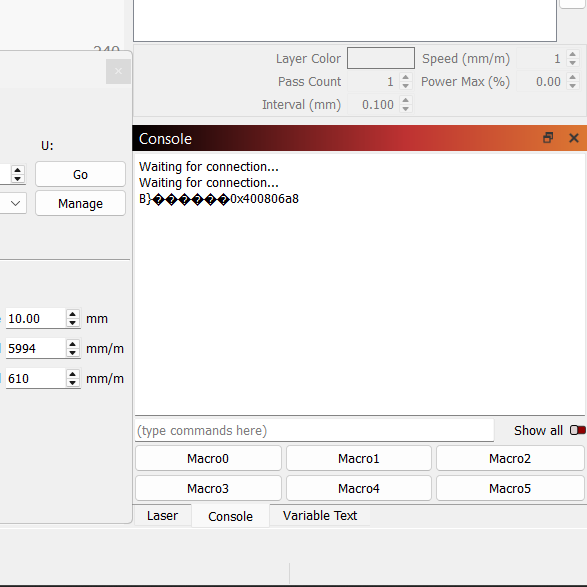

I have no recognition of my laser device(Wizmaker L1 36W) in Lightburn. I can see it, move it, and burn with it through LaserGRBL, but Lightburn does not even know I have anything plugged in. I have 3 brand new cables that I have tried, a cable connection is not the problem. I seem to have paid $100 for a program that I am not able to use. Please help. Also, the program has never asked me for my key. Is that weird? Maybe that is the problem? It may think I’m in a trial period?

Your laser, a Wizmaker, uses a 32 bit controller, so when creating the device profile for your laser in LightBurn, you should select GRBL-LPC as the controller type:

Let’s try again. You said you are able to connect and run the laser with LaserGRBL. Is this on the same machine you installed Lightburn? Did you disconnect from LaserGRBL before trying to connect with Lightburn?
What steps did you take to attempt to connect to Lightburn? List them in order please. Better yet, show screenshots along the way.
Yes, I even uninstalled LaserGRBL before trying to run LightBurn. Here is a short video of my situation.
According to @JessN you need to set this machine up as GRBL-LPC, not GRBL. Need to start there.
Thank you, but I have tried this and have the same issue. Wizmaker, and Light Burn, both have my device as a GRBL machine. I have even found a WIZMAKER.lbdev file on their website that is supposed to be the file to choose from, yet it still gives the same error message after I have it chosen as my device.
I see where Wizmaker says it’s GRBL. They may have updated their controller since JessN last worked with one.
In Lightburn open a new file, nothing on the screen. Drag and drop the .lbdev file onto the lightburn work area. That should install the file properly. It should give a confirmation message that it was installed.
After that, with the USB Cable disconnected, click on the dropdown next to the devices button and note the com ports. Then plug in the USB and turn the laser on and see if anything new appears. That’s your laser, select it.
If nothing new appears in the dropdown you need to go to device manager and see if it appears there.
When taking screenshots please don’t use phone pics, the glare and moire on the screen make it difficult to see.
Same error message. And still no control of the machine.
Does the dropdown change when you plug and unplug the USB?
Try installing CH341 driver.
Yes it does. I cannot have a port option show unless the machine.
I already have the CH341 USB to serial port installed. It comes with the machine. I would not be able to see a COM without it. is plugged in and turned on.
Ok, so you have the driver installed & the com port shows and disappears in the dropdown when you plug and unplug. You select the correct com port in the dropdown but the console still shows waiting for connection. Is this all correct?
I spoke with him for a bit this morning. He seems to have done everything right, but it definitely has a communication problem. Gets jibberish in the console window. It works with LaserGRBL and another software he mentioned, maybe Wizmaker’s software, not sure. He even tried 3 different computers, all with the same results. I suggested he email support, as there is nothing else I can think of.
