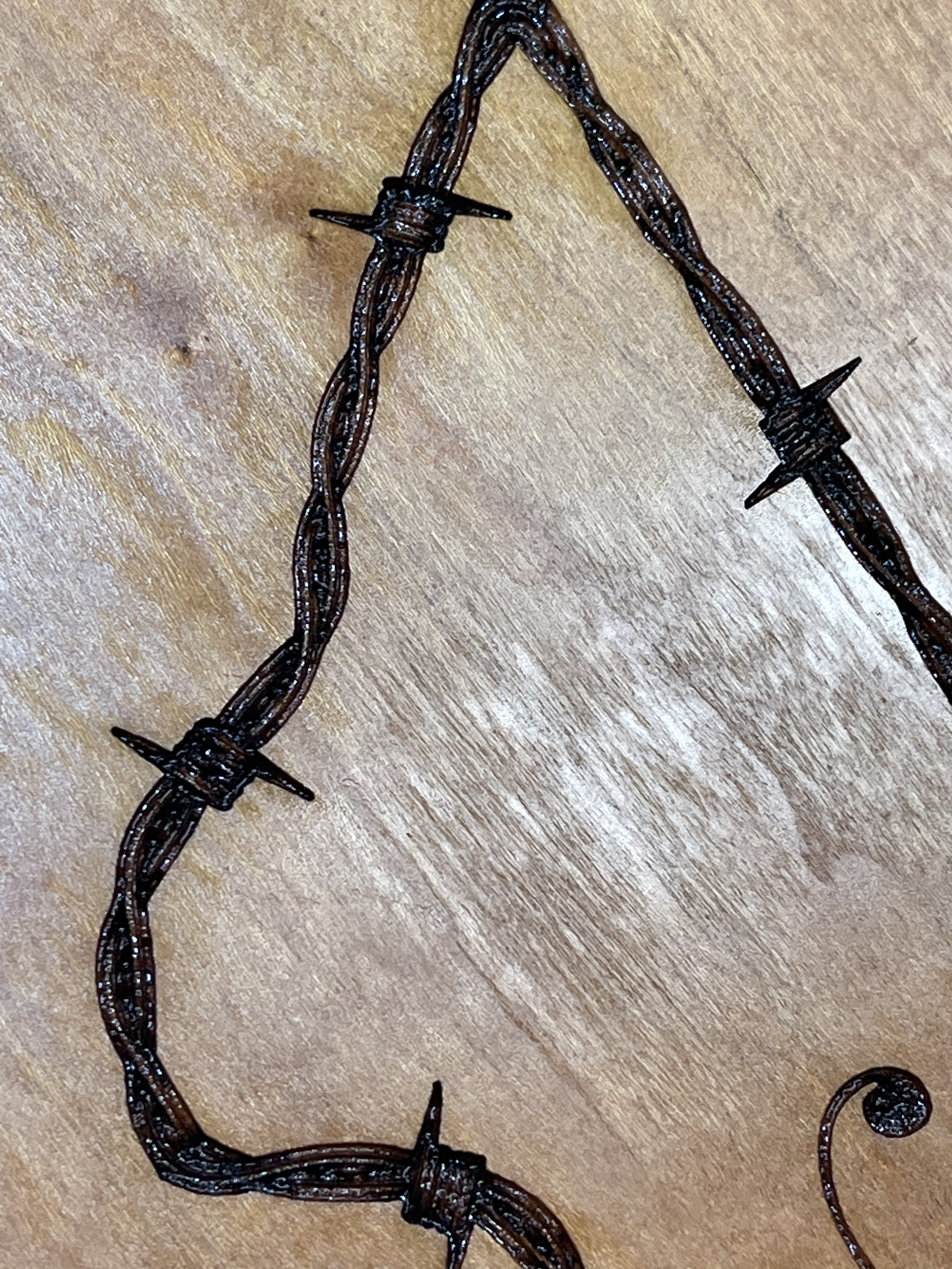

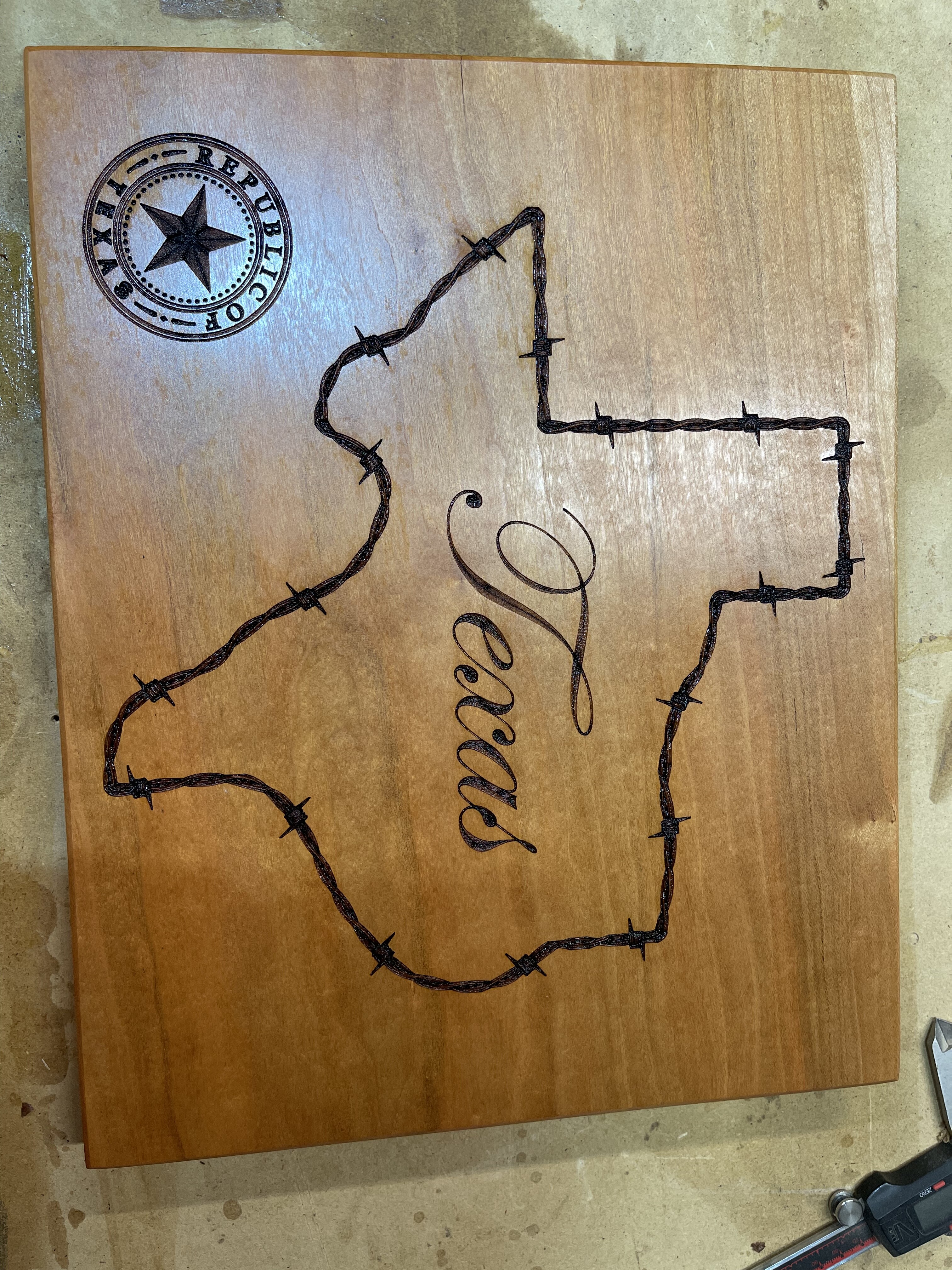

One other thing I’ve found is doing a fill pass vs offset fill makes the etching a lot lighter, even with higher power on the fill. I used an offset fill on the barbed wire board while using fill on the other cutting board. I used the same speed (200mm/s) and 20% power on the offset fill, 35% power on the fill. They both have their uses… for the barbed wire, the offset fill is gold.
I’ve seen “offset fill” in the drop-down box, but I have, as of yet, not gotten around to playing with it. As I said earlier, I really don’t want to go back to it taking 1.5 hours to engrave a cutting board when I can do it in half the time, and still keep my clients happy. Time to get out the coaster blanks and do some experimenting. Thanks for the tip (your numbers are very close to mine on Acacia).

That Texas board took me 22 minutes to cut. It takes 41minutes on fill mode. A 6" x 9" board takes 16 minutes on fill and 10 on offset fill. If I get to coaster size, Lightburn says it takes less for the offset fill but in reality, the regular fill is slightly faster.

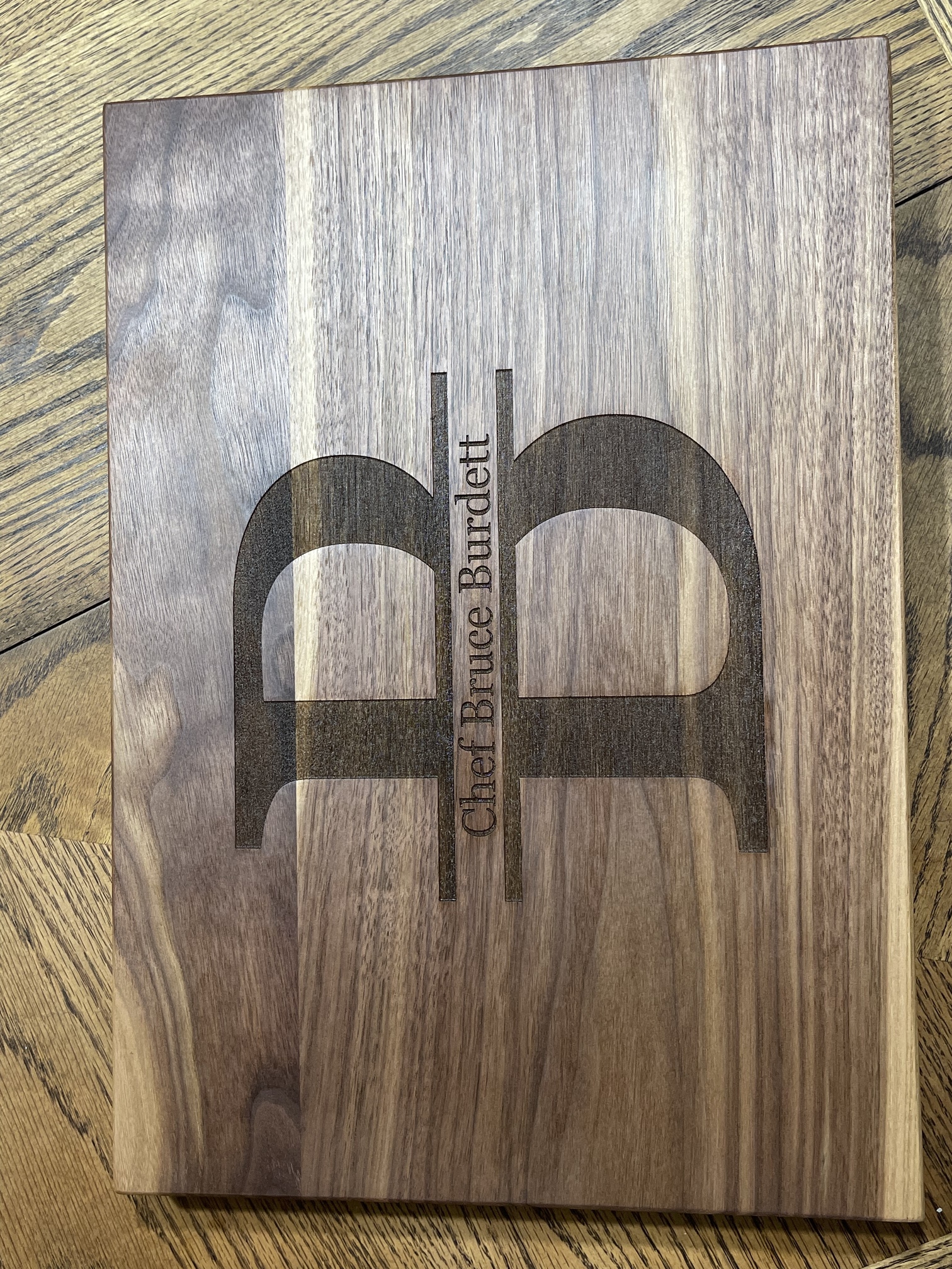

The cutting boards pictured above were done with “flood fill” enabled, otherwise it would’ve taken 3 plus hours. It’s weird how sometimes “flood fill” is faster and sometimes it isn’t. I had a small job yesterday, a little bit of text and a small graphic, and it was 5 min. with FF enabled, 3 min. with it disabled. It’s some kind of sorcery if you ask me :laughing:. Most of the time FF is the quicker option (as long as you’re not running it too fast).
Increase the lines per inch setting to 400ish.
