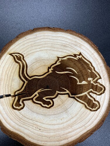

Cannot get image dark enough with CO2 compared to Diode
Any suggestions on how to get a darker image with a CO2 laser? It seems all it does is go deeper into the wood, but doesn’t darken it like my diode used to. The power grid is my CO2 and the Lions is my diode. To get the image that dark on CO2 I’d have to burn down very far into the wood so that the shadows create the darkness which is a dumb way to do it…

Well, if I was to take a value from the test grid of the CO2 that I would consider not too penetrated … I would say 350mm/s x 21% power (again not being very dark) vs. my diode laser at 3200mm/min and 60% power

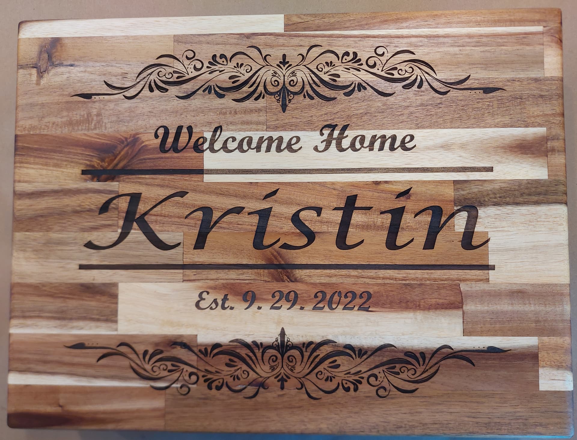

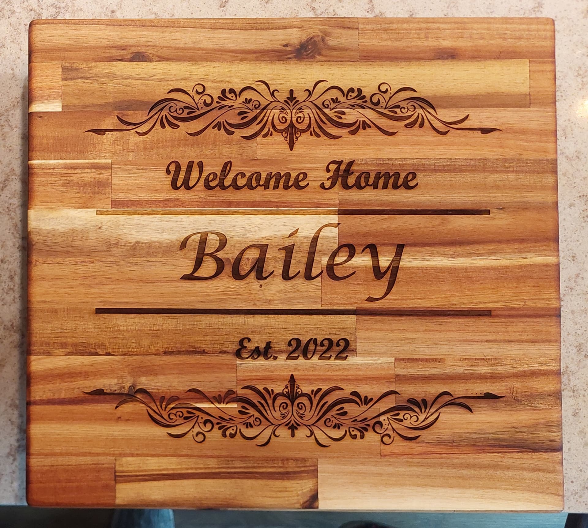

Right or wrong I’ve avoided using borax (I don’t want to open that can of worms) because most of what I do comes in contact with food. I’ve engraved some 20 plus of these cutting boards (for a local realtor) over the last ten months, first with my 5.5w Ortur diode laser (which helped pay for a 50w OMTECH), so I too was concerned about the quality of the finished product when I started using the CO2 laser. I can see the difference in the areas where the wood is lighter, but the mineral oil I use after engraving helps to make it less noticeable. You can see it in the horizontal bars above each of the names (Kristin is diode, Bailey is CO2). My clients haven’t complained and 45 min. sure beats 1.5 hours for engrave times. I use Acacia butcher block countertops from a local hardware store, and I’ve found a setting that gives me results that are fairly close to what I was getting with the diode laser. Picking the darkest piece of wood has been key for me.

The one thing that helped me the most was after engraving a design with the diode laser (a 4X4 Acacia coaster) I kept repeating it on the CO2 laser until I got the same level of darkness. In my case it was 250mm/s @ 35%. The design was small enough that it could be repeated very quickly. And every four that I did I had another set I could either sell or give away. Just my 2 cents worth.
