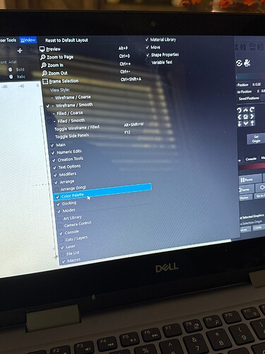

Cannot maximize or minimize light burn. Also color pallet is checked by does not show at bottom HELP!
I cannot get color palette to sho no matter what I try. I also cannot maximize or minimize the light burn screen. Any help is appreciated!! Can’t really use it until I can do layers and without that at the bottom I am at a stand still … HELP PLEASE!!!

Please post a screenshot (not a phone pic) of your entire screen with the menu closed so we can see what you’re seeing.
Try WinKey+UpArrow.
Had to use it myself about 5 minutes ago! :roll_eyes:
That worked!! Thank you so much i have spent days on this not knowing how to fix!!! I appreciate it!!
