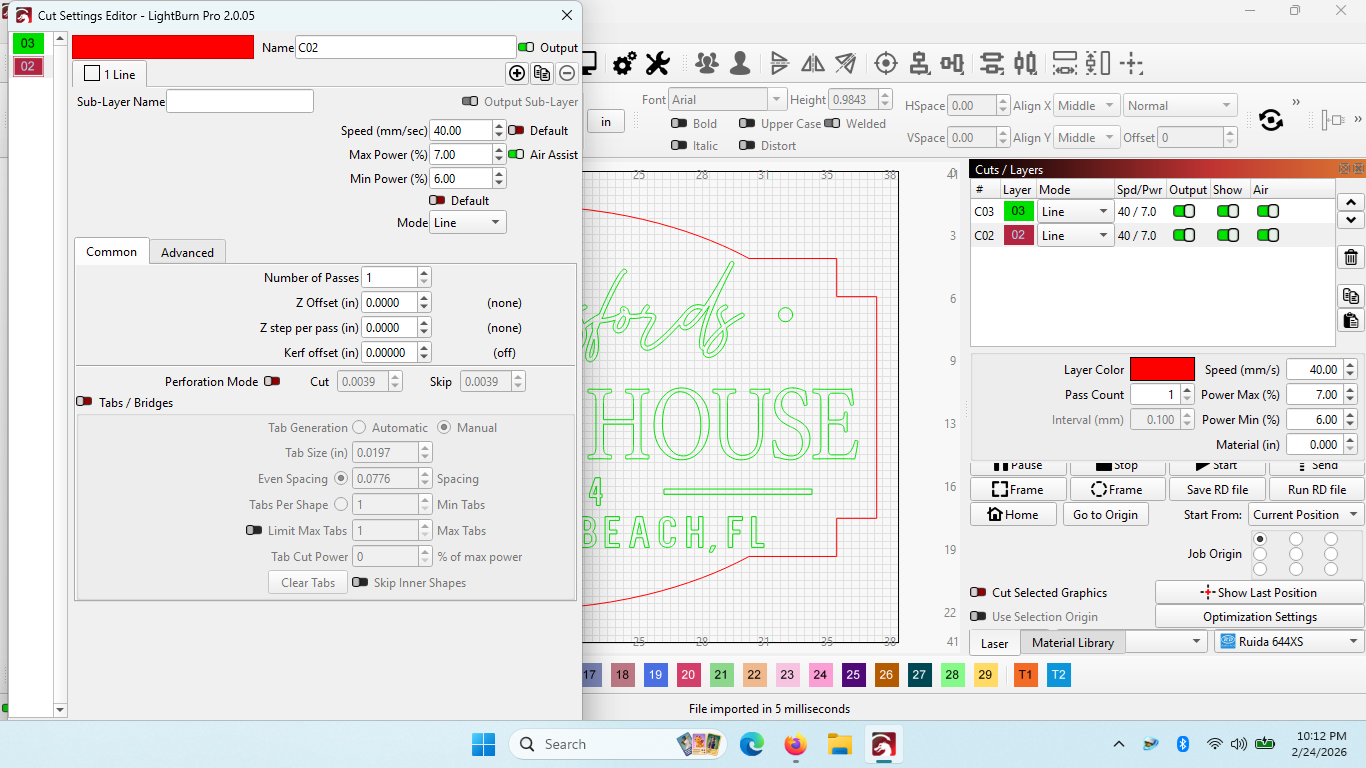

I am still having difficulty with resizing the Cut Settings Editor dialog box.
Seems like it first started with V 2.0.02. Still happening with 2.0.05.
Win11 1366 x 768 display
Cannot shrink or shorten.
Cannot get to the buttons at bottom of the box. i.e. “Make Default” (Any workaround for activating the “Make Default” button?)
I tried going into Properties off the shortcut icon Compatibility - Change High DPI Settings - Override - System Enhanced as instructed in a YT video.
No luck with that change.

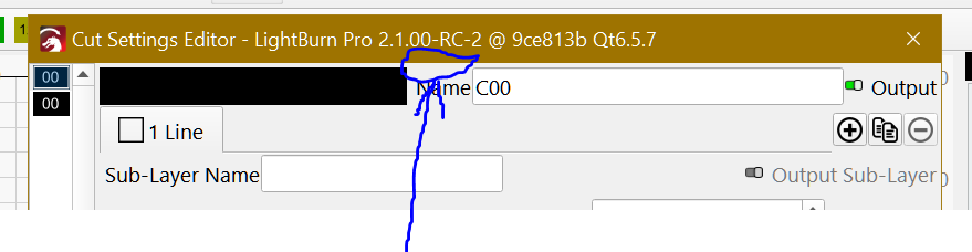

Try dragging a bit the window by the window bar bottom to the upper side of your screen
That is the problem. Cannot access the bottom, its off the screen. The box can be moved left to right on the screen but the box height cannot be down-sized to get to the “Make Default” button on the bottom. Does anyone know of a shortcut key to activate the “Make Default” function in that window?

Sorry. This is a possible workaround.
I meant to grab along the indicated bottom line of the window bar:

Thanks for that info. Unfortunately, no mine does not move that way. I can right click and select Move, and the box will go right/left/down. But it will not go up. Nothing I do will give me access to the options at the bottom of the box.

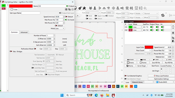

@Colin forgot to add, if you have vision issues. Here is mine…
