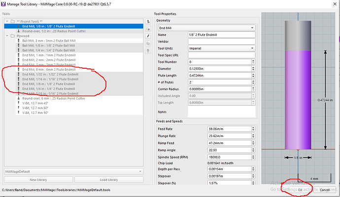

Can't add or edit tools in any library
I’m running the latest relese build of Millmage. 0.8.00 R19. At first, I could edit tools and add new tools. Now can’t edit any tool in either a new or exisiting librairies. As soon as i choose EDIT from the menu, the OK button is greyed out preventing any updates to be saved. I also don’t understand why some tools have grey bars behind them. Thank you for any assistance on this!
You’re running the RC, which is not the latest - the latest is the release, and this has been fixed.
The tools with grey backgrounds are Imperial tools, and the others are Metric.
