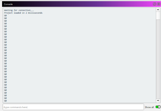

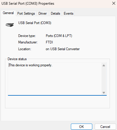

If it still doesn’t connect, please make sure that the controller shows up in Windows Device Manager, and that the correct COM port is selected in MillMage. Send us a screenshot if you receive any errors in the Console Window with “Show All” enabled.
I enabled DTR signal. No change. Still won’t connect. Attached are screenshots of my Windows Device Manager and the Console window in MillMage with show all selected.
