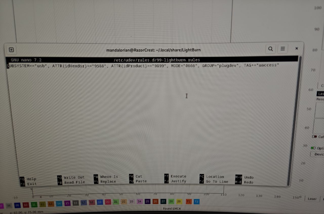

Hi everyone, I have a weird problem, I got a galvo machine and add it on my installation and was working fine, well my laptop died, so I got another laptop and installed Debian, installed Lightburn but I can’t connect to the laser, it doesn’t the detect the port, but if I open Lightburn with sudo it does detect the port, I was reading about user permission, I added my user to dialout and tty group but still the problem persists, any idea why?

The answer to that question is definitely a permissions issue, but on which device is the question.
Can you do the following steps?
  1. Unplug the laser
  2. Open a console
  3. Type in sudo tail -f /var/log/syslog
  4. Plug in the laser
  5. Paste the output of the new lines appearing in the console
  6. Ctrl-C to exit the tail command
Fiber lasers can be a device other than a serial port, sometimes they’ll be an FTDI device or something else entirely. We won’t be able to track it down without knowing how Linux interfaces with it.

25-07-30T18:45:29.741878-06:00 RazorCrest mtp-probe bus 1, device: 12 was not an MTP device
25-07-30T18:45:29.815339-06:00 RazorCrest kernel: [ 683.020672] usb 1-3.2: new high-speed USB device number 13 using xhci hed
25-07-30T18:45:29.915256-06:00 RazorCrest kernel: [ 683.121696] usb 1-3.2: New USB device found, idvendor-9588, idProduct=9899, bcdDevice= 0.00 525-07-30T18:45:29.915302-06:00 RazorCrest kernel: [ 683.121710] usb 1-3.2: New USB device strings: Mfr=1, Product=2, SerialNumber=3
225-07-30T18:45:29.915308-06:00 RazorCrest kernel: [ 683.121717] usb 1-3.2: Product: USBLMCV2
025-07-30T18:45:29.915312-06:00 RazorCrest kernel: [ 683.121722] usb 1-3.2: Manufacturer: BJJCZ
025-07-30T18:45:29.915316-06:00 RazorCrest kernel: [ 683.121727] usb 1-3.2: SerialNumber: 20120331001
I

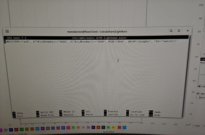

Well, I finally got it working, I have to create a udev rule
SUBSYSTEM=“usb”, ATTR{1dVendor)==“9588”, ATTR(idProduct)==“9899”, MODE=“0666”, GROUP=“plugdev”, TAG+="uaccess

Just to add more info, I fixed my other computer (there was a problem with the ram slot) didn’t have any special udev rules, I copied the same permissions, and still no good, I’m not sure why this computer needed a special udev rule, I mean the only difference between this new computer and the other is the new one is using Debian Stable and the old one Debian testing
Debian stable generally lags behind testing in terms of versions, and the udev rules get updated as the device database gets validated and expanded over time.
I suspect that this is what happened to you in this case, the stable version is focused on stability and requires a lot longer testing and validation of any updates before it’s integrated.
