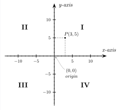

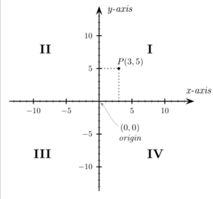

This setting tells LightBurn in which origin your machine is set to work. Think cartesian coordinate quadrants:
LightBurn uses this information to subsequently adjust the commands used to control the laser.

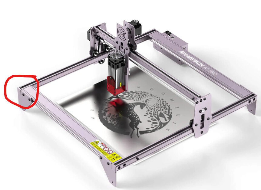

The circled portion here indicates the front left of the machine:
If it is turned 180 degrees then either turn the laser around or do everything as if it were turned around. So start the machine with laser-head at top-right. That will be your 0,0 origin position.
