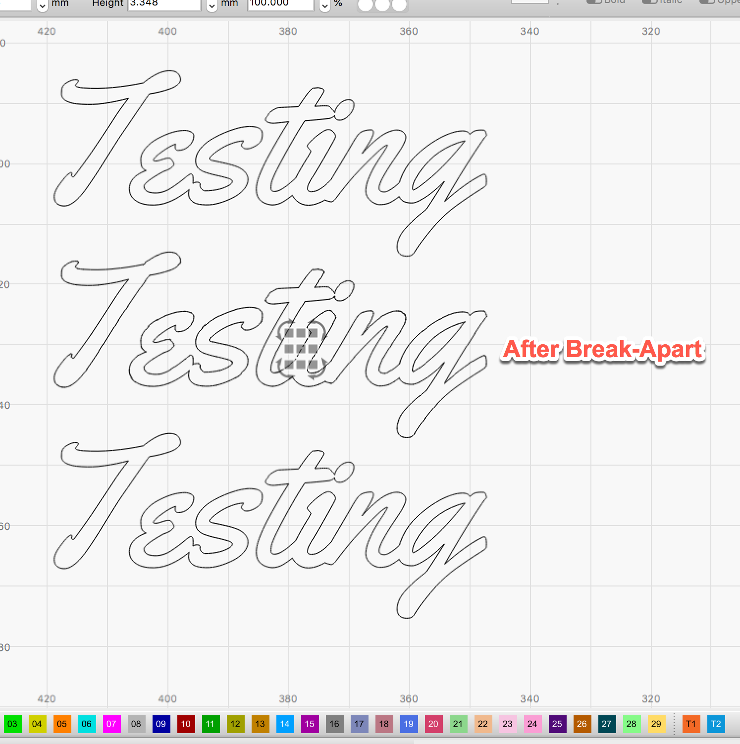

Break Apart is overkill and not the correct tool for the task. Break Apart will deconstruct a shape to its basic elements, lines and curves, which is deeper into the deconstruction than required and may actually make it harder to work with after if not intended and understood.
You can try to reassemble these disjointed shapes by selecting all components of a single path shape and select Edit→Auto-Join selected shapes.
LightBurn has a hierarchy for drawn objects. Text, along with rectangle, ellipse and polygon shapes created in LightBurn is known as ‘primitive objects’. Converting these shapes to paths would be the first level of deconstruction, and will convert these primitives into closed path shapes. Break apart goes a step further and deconstructs the shape to the elements used to create the shape.
I would suggest using ‘Convert to Paths’ for this text edit work.
