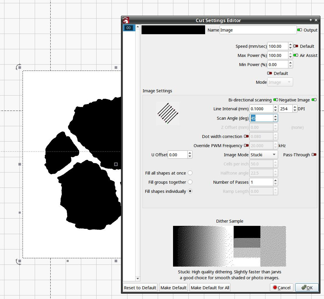

What I am looking for is the SCAN ANGLE setting… as far as I can tell, its only used on “passthru” images, not lightburn modified images. Its in the same area, a few options down from the bi-directional toggle, but same menu screen. At least my old version had it there.
Might be a GRBL thing, as the Cut Settings for my Ruida controller has an active Scan Angle field for any Image Mode:
The usual caveat: Ruida controllers have hardware support for 0° and 90° scanning, so using any other angle is a Bad Idea.
Perhaps it’s a subtle difference based on image type / tracing / specific GRBL flavor / moon phase?
Scan angle is available on GRBL controllers so that shouldn’t be a problem.
@Kwynn Can you take a screenshot of what you’re seeing?
