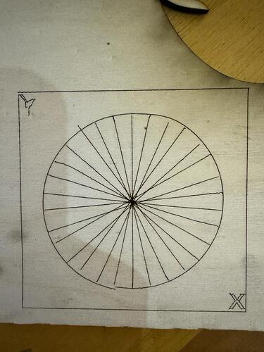

This was realy helpful and changed the belts and it really made a big difference but still the circles and the shapes dont close properly :frowning_face: , any idea what could be the problem ?
Considering the test results there are 2 things that seem evident
a) your Y belts are loose, or maybe unbalanced left vs right
b) your X belt needs a little tightening too
What you have there is 90% hardware fine tunning.
Belts
