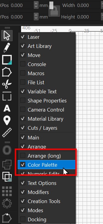

I just updated to a newer version and can’t get my layer palette to come up as a tool bar. Could someone direct me on where to turn that feature on please
For the palette with all the layer colors:
For the Cuts / Layers window:
If those aren’t it, a few more details will be helpful.
If you’re on a Windows computer with low screen resolution press the Win key and up arrow.
