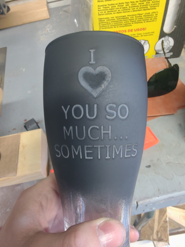

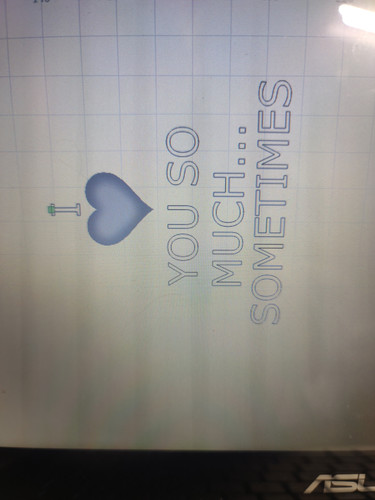

Using the atomstack a20 pro. 2000mm @ 85% power. I’ve messed with my setup and my design, and I just can’t get this to work. The best results still have the “I” off center. It’s the last step in the engraving process, so it may have something to do with that. It’s centered in the program and preview. I’ve double checked level of the machine. I found that the frame was level, but the body of the laser and the Y(?) Axis rail were off a little. So re-leveled to the laser, not the frame. I have stoppers on the roller body, because I found that cups can walk during other projects. Likewise, I have a heavy nut on the roller extension. I lowered the speed from 2500 to 2000 this last time. I have the image set to grayscale. EVERY time I run this project, regardless of other potential errors (like walking), the I is never centered. There have been a few times it was to the right as well.

I think that makes sense, I’ll have to figure out how to measure and mark the exact starting position. That doesn’t seem like too big an issue I guess, but do I just do a separate job with nothing but the same size “I”?
Alternatively, is there a way I can change the engraving order? If I could get it to start at the I, then the heart, I feel like there would be less chance of being off.

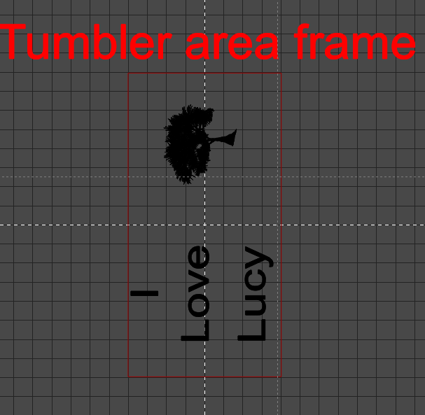

#1 - make a frame that fits the tumbler engraving area and insert text and graphic for opposite side. I adjust the size of the frame so that one length of frame = 1 revolution of the tumbler. I manually space the text and the graphic for equal distance. I count the number of squares on the left, right and between the object and text - then move to make left +right equal to center spacing.

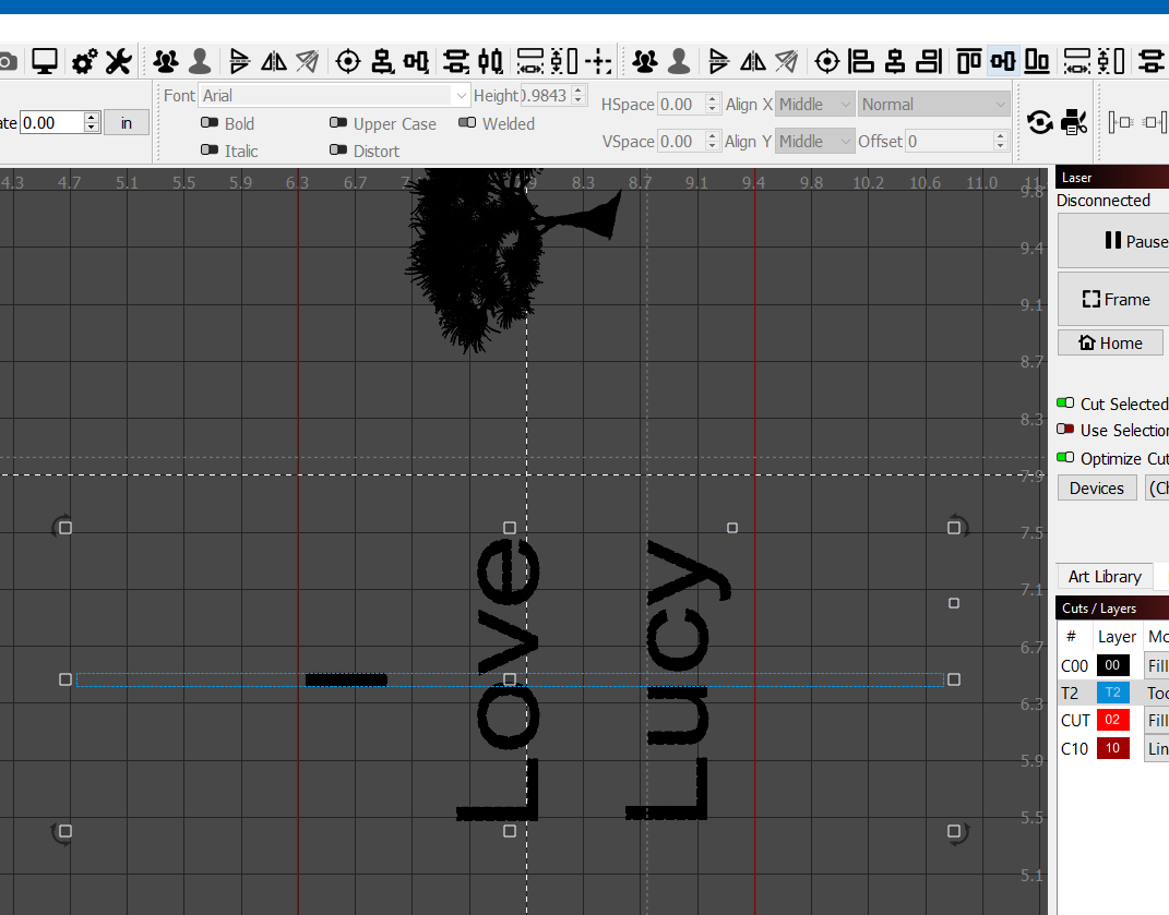

#2 Make another frame around the “I”. Select the Frame, the “I” and the other text - center them vertically (light blue box in the top right of this screen grab - then you can right click and lock the objects in place for added security:
#3 On the laser tab, select Cut Selected Graphics. Select everything but the “I”. Run the job. Then select the blue frame and check where your “I” will engrave by using the Frame command Adjust the tumbler/roller or the graphic on the workspace until you are happy, then
#4 Finish the job by engraving the “I” where you expect it to go.
