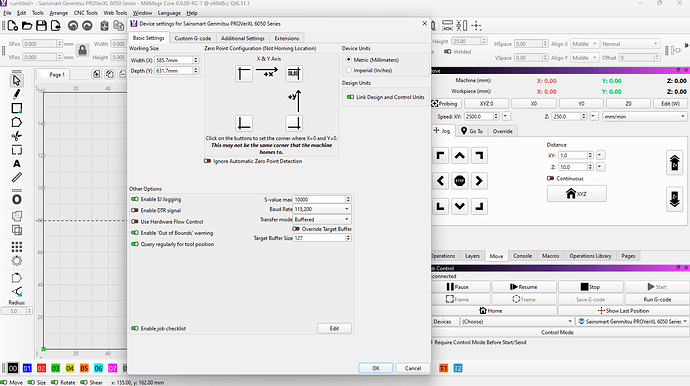

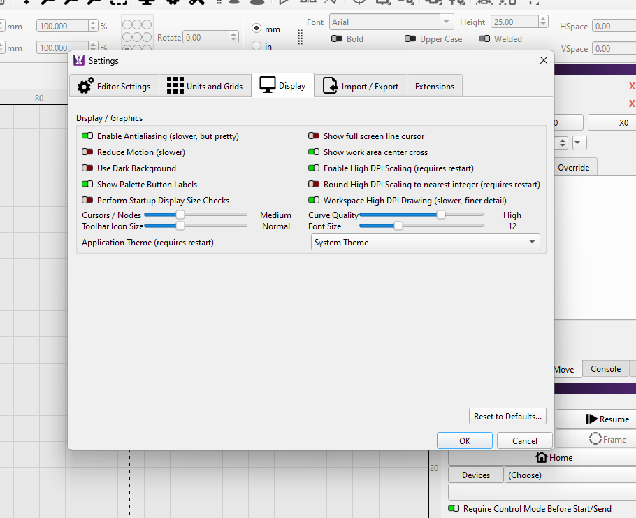

Can't see full window in probe
Ok, you answered question #2, the double squares show the window is maximized (full screen).
oh, ok here are the screenshots… I showed where I tried the display both ways as well.

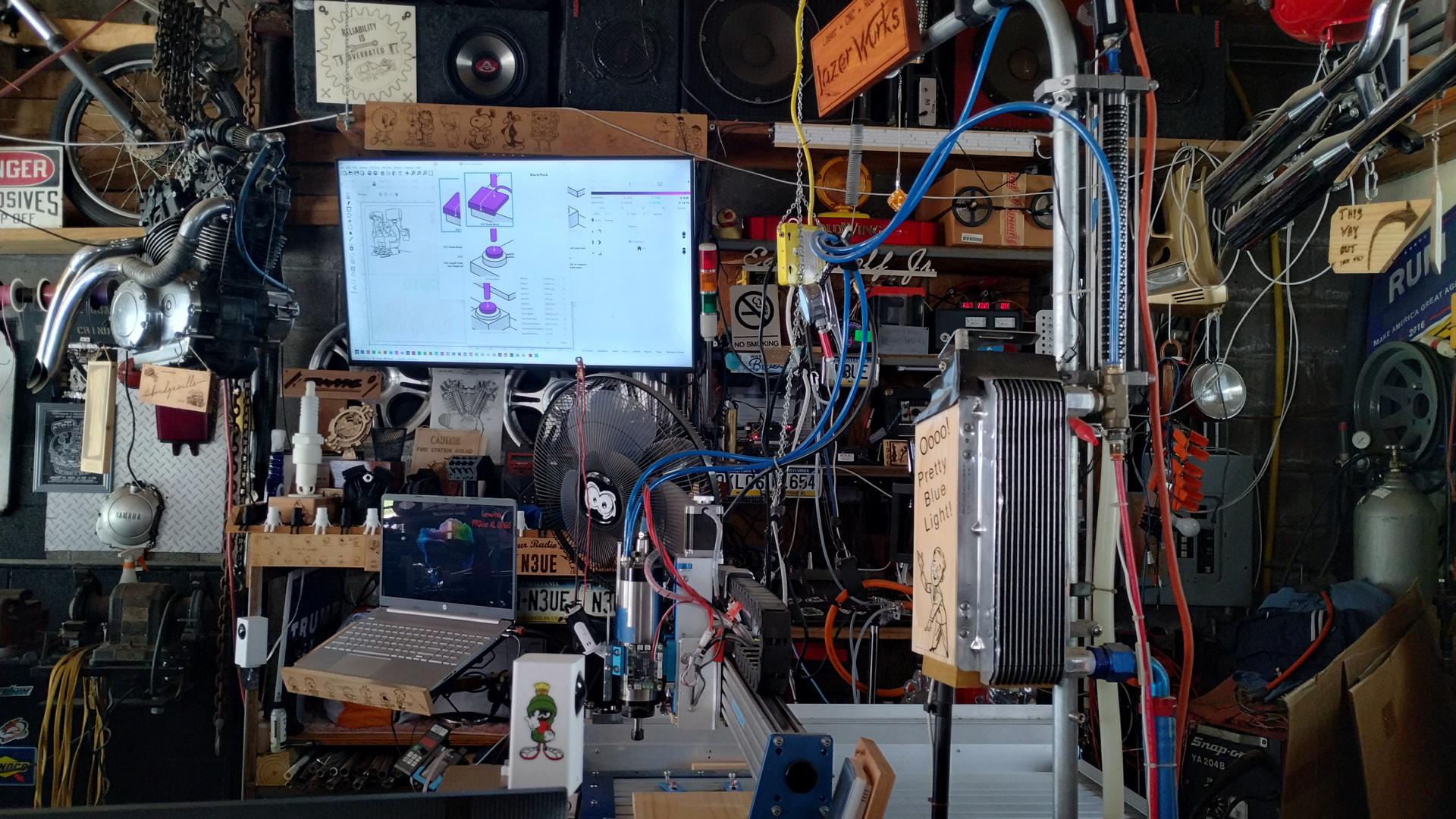

Ok, it looks like you are in the same boat I was in. I ended buying a new monitor, which ended my issue. To make it work without a hassle, I view on the 27" HDMI monitor and the laptop screen is off if the HDMI is plugged in.
Laptop: 1920x1080
Monitor: 2560x1440

thanks, I have it on my 50" screen, but for me, it’s not worth the extra $100 for the program for this reason only. I regret paying the first $100 now. I will be reverting back to Easel.
You are using MillMage Core.
Before you leave give a shot to the Pro features:
I was trying the .9 of Pro. I’m not buying a new computer just to run it.

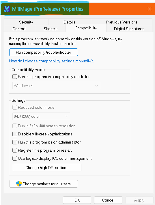

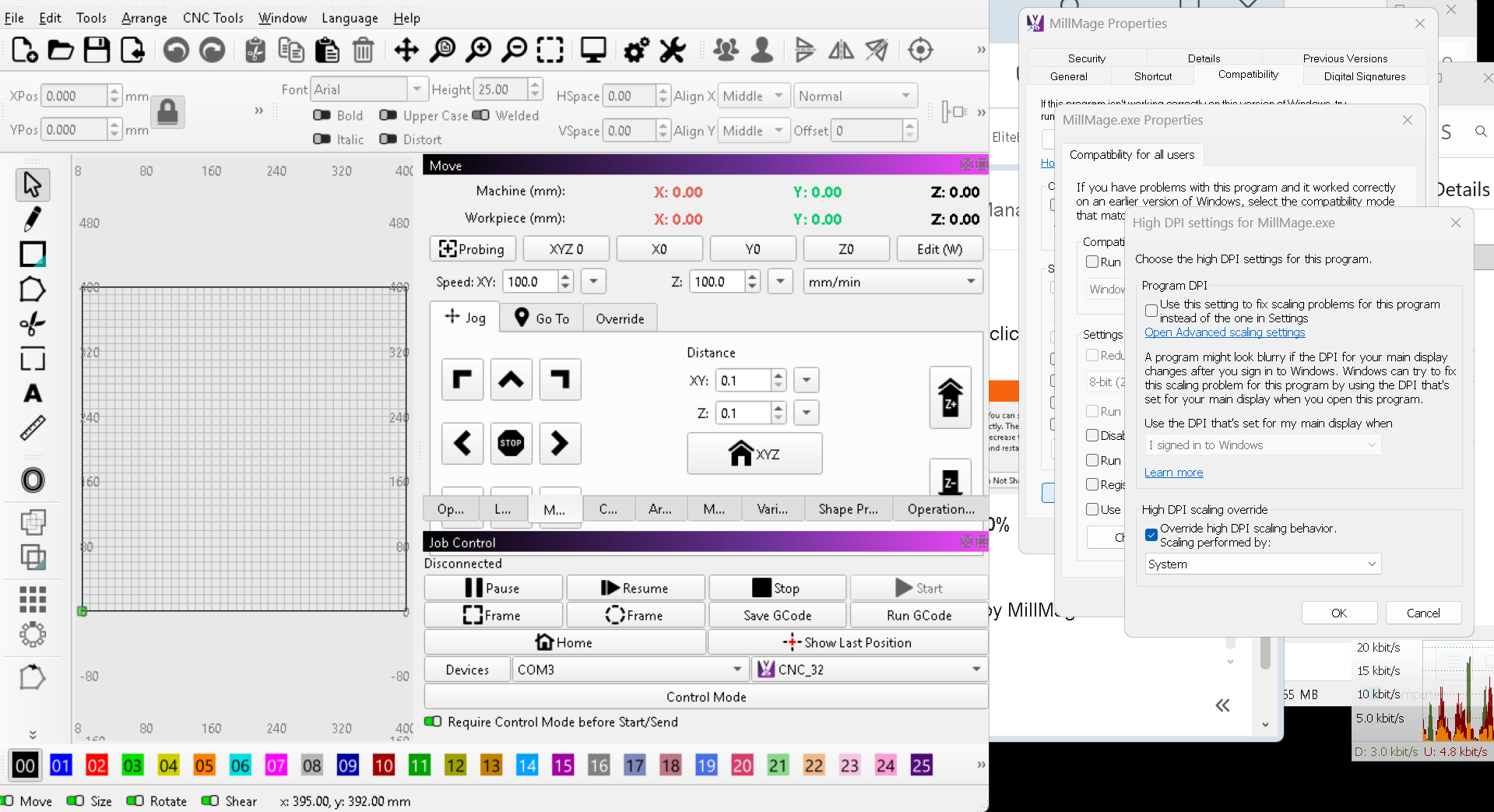

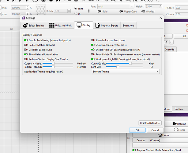

Try this:

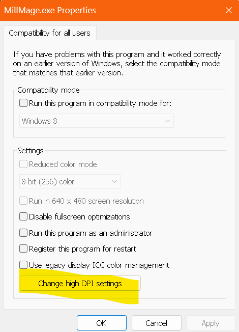

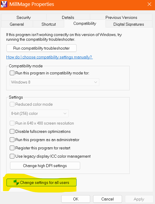

Right-click MillMage.exe , select Properties, Compatibility Tab and Change settings for all users
Change high DPI settings
Select Override high DPI performed by System
Click OK.
Then Apply and OK:

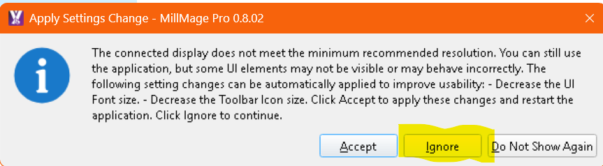

After Start MillMage with a warning, just click Ignore and report back:

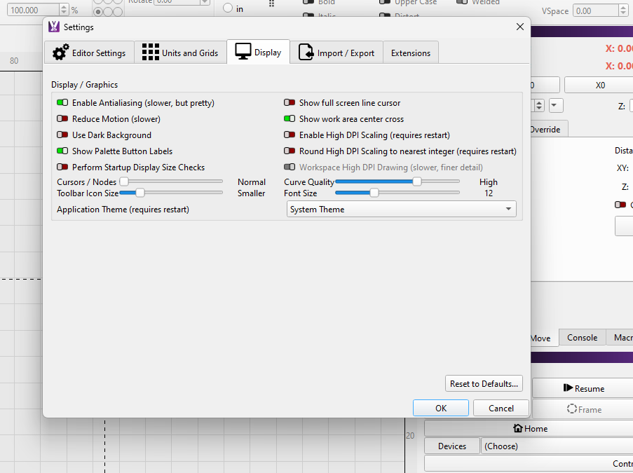

My Laptop works fine with high DPI set by MillMage and by System.
That did not help…

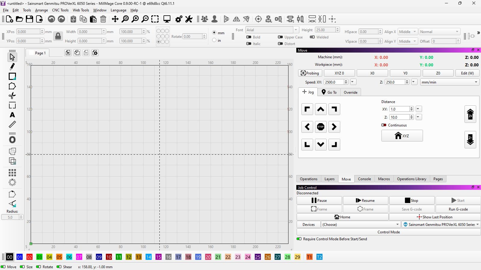

So, I have both versions,

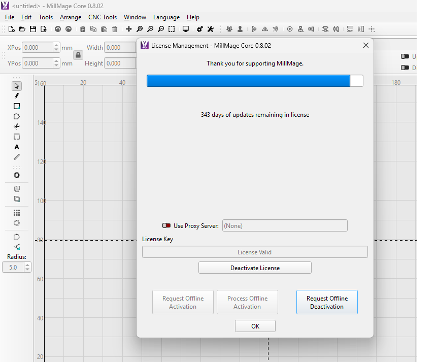

0.8.02 the windows are perfectly readable

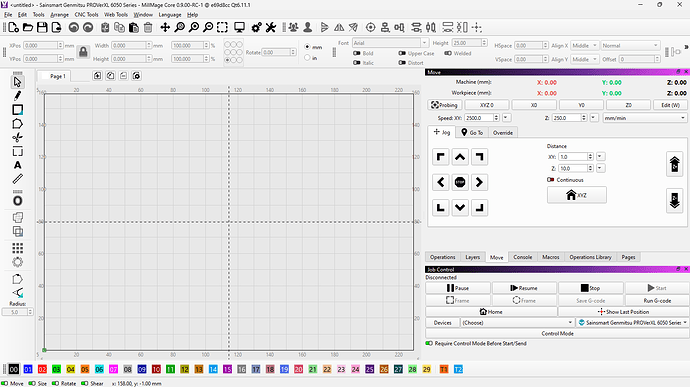

0.9.00 the probe windows are too big, not readable
Sorry, try the above DPI steps with 0.9.00 RC, MillMage (PreRelease):
am I missing something here, with your attached image?
As the DPI steps where for MillMage core and to clarify did you try the above steps with MillMage .exe that is in the MillMage_PreRelease folder?
oh, yes I did.
