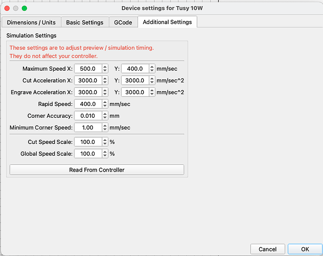

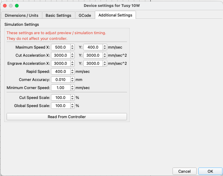

Did you load the settings from your laser into Lightburn? Device Settings(Wrench & Screwdriver icon) Additional Settings tab. Click read from controller button with laser connected. This loads actual parameters from your machine into Lightburn for it to be ble to caculate times. If you didn’t do this step Lightburn uses default values which are probably not correct for your machine. The times given are usually close to actual times, bt 100% correct is not possible.
