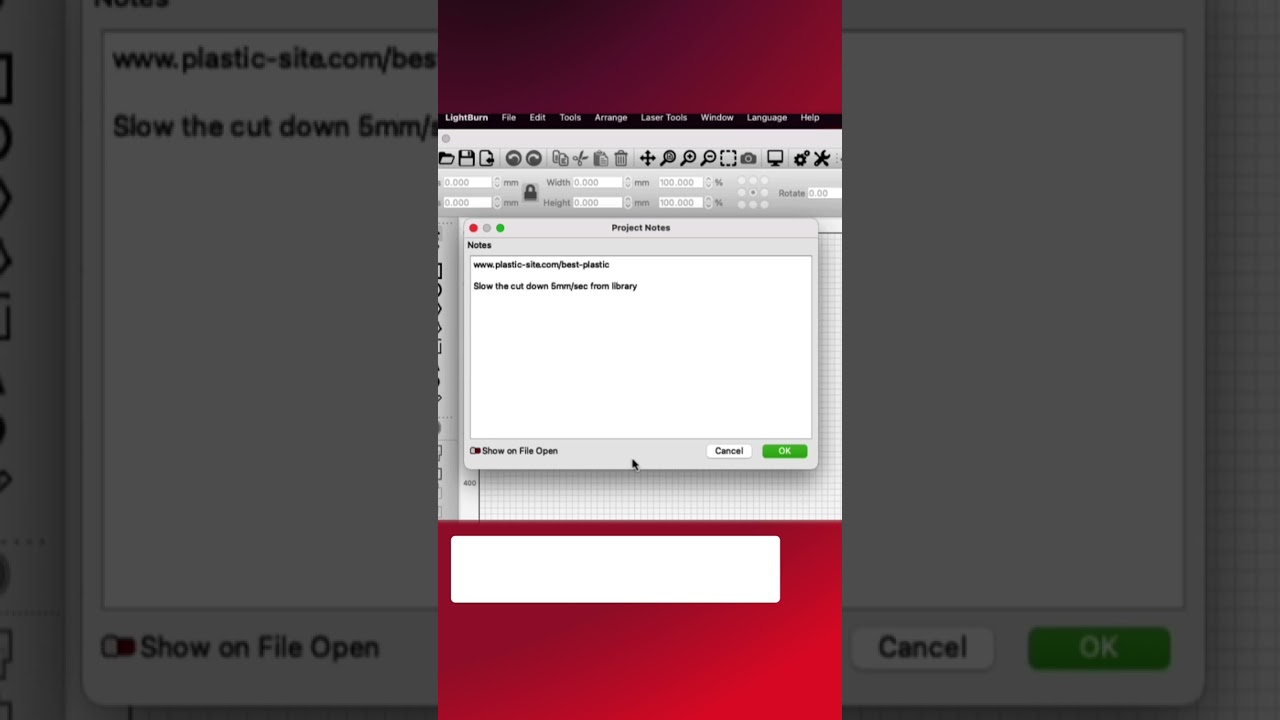

There is also a Project Notes tool in LightBurn.
