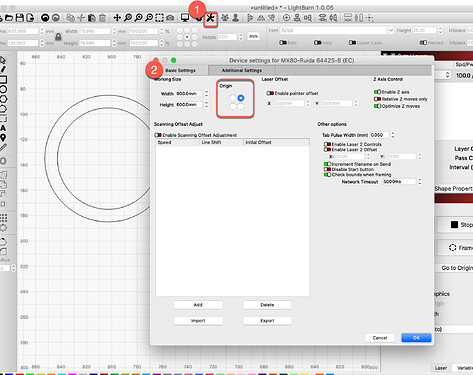

Can't set origin on Ortur Master Pro 2
I can’t get the origiin to set. it always goes to x = 160. I have it set for Absolute coords, Also I buggered up the side panels. The block that says Set/Clear Origin is gone.

As for the origin issues, share where you have the origin set in LightBurn currently, along with your current firmware settings. Type $$, followed by Enter / Return, into the ‘Console’ window, then copy and paste the entire results here for review.

The laser head stops at about X= 16 CM (if I remember correctly thats 160mm) x Y= 1.5 cm.
I think I found part of the problem. I had been using LaserGRBL and it was Locked. I unlocked it and and now pressing Go To Origin does nothing. The laser head has always returned to x=0 y=0 for home.
I have nothing bad to say about LaserGrbl. It is a great, very simple program to get people hooked on laser engraving.
Is it possible that you are mixing up home vs origin? Home implies doing a homing operation and should go to 0,0. Origin is a user defined origin and will change based on what you have that set to.
If you push the home button, does the machine auto-home to 0,0?
You can set and clear origin in the “Move” panel.
