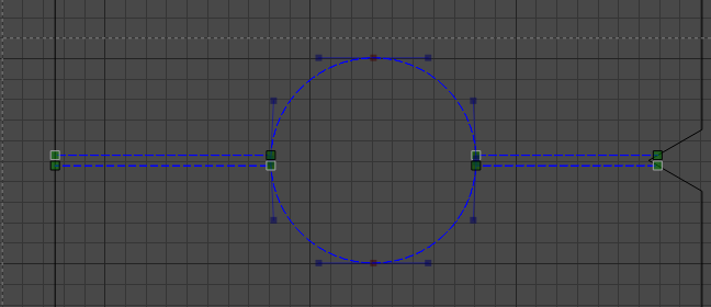

Can't ungroup 2 objects
I have a p90 guitar pickup templet that I am preparing for a cut. If you select any blue layered circle/sphere, you will find a line attached to it. I can’t ungroup or separate the two. I dropped this in LB as a .dxf file to start working. Am I missing something basic here?

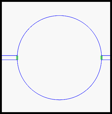

Do you want to trim out the area in green?
Yes. I didn’t see those. I guess the laser would have to go there twice and do something.

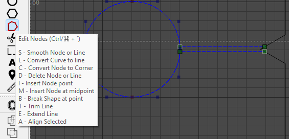

The lines and the circles_almost- shape are on one object. To separate them, you need to NODE EDIT.
Got it. I didn’t go that deep yet. I was just moving the sphere again and only one line is attached. Is that what certain files do upon import?

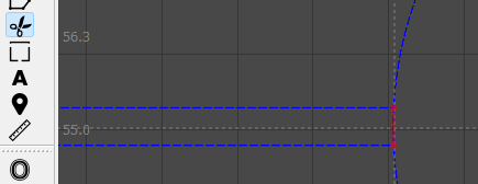

Use the scissors tool to trim out the areas in greeen
You can use CUT SHAPE (scissor tool), at least on the parts I tried.
You would have to post the DXF file, but it looks like the DXF was not created with a circle entity, and that is why LB joined the line.
Cut shapes is a different tool: Cut Shapes - LightBurn Documentation
You mean “Trim Shapes”: Trim Shapes - LightBurn Documentation
