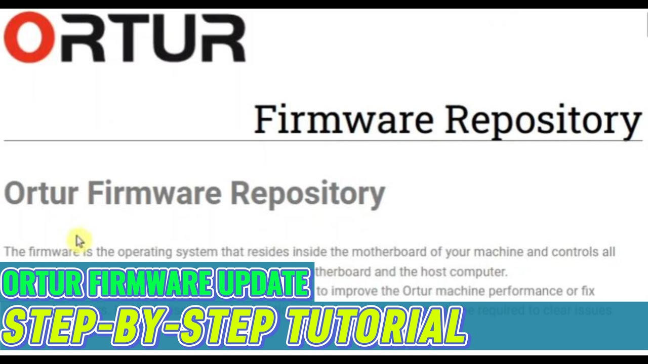

I purchased a Ortur Laser Master 3 LE used but it was a brand new machine in a never opened box. I mention this because it sat for a couple years since purchase, so it does not have the latest firmware revision (209) but instead has (208). This older firmware has a bug that adds .0001 inches on each line of an image. All my cuts are nice and accurate, but all my images slant to the right. I have confirmed the belts are all set correctly and mechanically the machine is fine. It is only with images do I have this problem. From this forum I learned about the image bug in the old firmware version. So I have been trying to update my firmware to the latest 209 version. I know I am doing it correctly and when I update it, it actually looks like its updating. I followed the Ortur video instructions and my machine and laptop does exactly what the Ortur video does. I can see the firmware updating real time (see pic). The machine powers down after just like the video and it looks like it updated perfectly. But when I reboot the laser and I go back into lightburn and check my firmware version, it is still 208 and I still have image skewing

I have fixed it!!
The video ORTUR offers doesn’t have the complete instructions
I found (somewhere on their website) the written instructions for the LM3 LE firmware update
Everything the video shows is 100% accurate but when you are completed downloaded to their machine you must go back into lightburn and type in a command in the “console”
The command is
$RST=*
Then after the command is entered the firmware update takes hold
I retested the images and skewing is gone!

$RST=* is the GRBL command to “Clear and Load all data from EEPROM.”
I see two videos about upgrading the firmware on an Ortur LM3 but both don’t mention this. Do you remember, which one you followed?
@Aries-ORTUR maybe, you would like to forward it, that the instructions in this video don’t work, and that the written docs here are more accurate:
This was the video I used (not sure if it’s an official Ortur or not) because he has the LM3 LE machine and that’s what I have (it’s a little different than the regular LM3).
I sent the info about this to Ortur and let them know the video is missing a step
