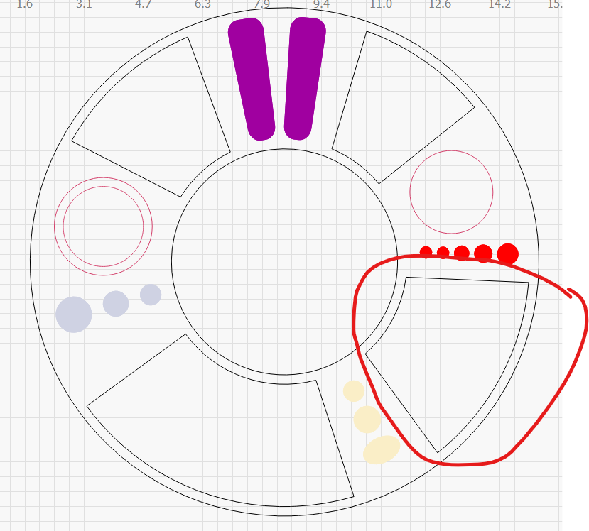

Cant use raduis after joining two shapes
I am trying to create lazy susan graphic in Lightburn. After joining two shapes, I cannot seem to get the Radius to work on the resulting shape’s corners. I have created “trays” around the center of the lazy susan and cannot get the radius to round the corners (see red circle).
Can someone assist?
I don’t believe you can create a radius where one of the adjacent line segments is a curve. I believe you need to have lines on both adjacent corners.
If @berainlb suggestion doesn’t work… can you post the .lbrn2 file here for us to examine…?
