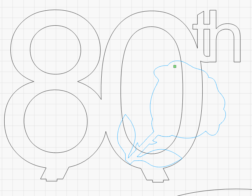

this is what i was trying to weld but it would not allow
i even watched various utubes on it it would not even allow me to edit pionts

this is the file i even made sure that it was closed i woulnd care i welded the 8 the zero and the tabs and the polygons and the th but it would not let me weld union the background of the rose.

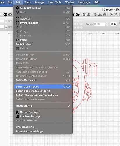

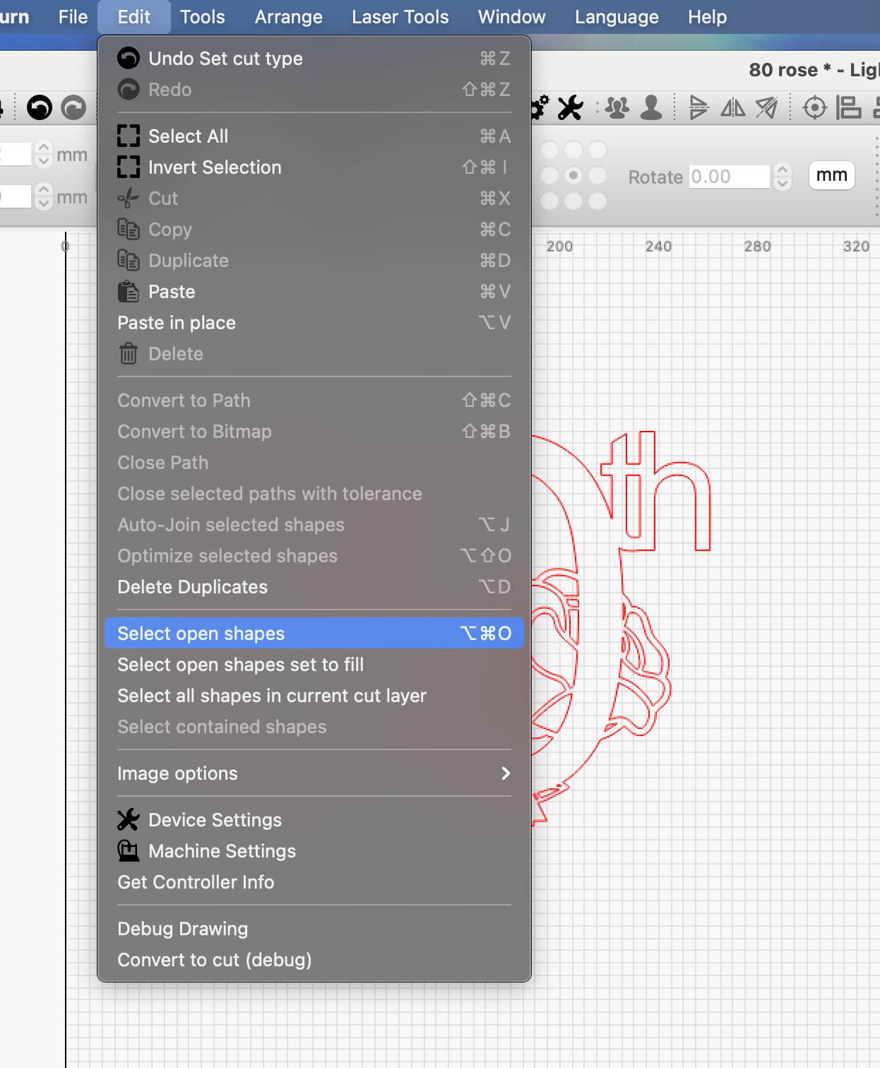

One of the most important shortcuts, in my opinion, is “alt+cmd+o” - (o as open), I always use it.

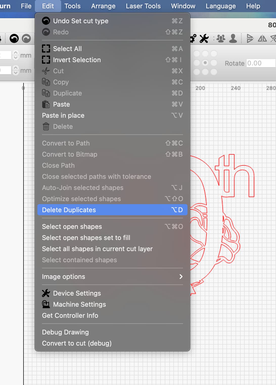

As another part of the workflow, I always check for duplicates. Duplicates can be very annoying because you usually don’t notice or see them until you run into problems.
“80” is ok, no duplicates left and no open shapes here - fine.

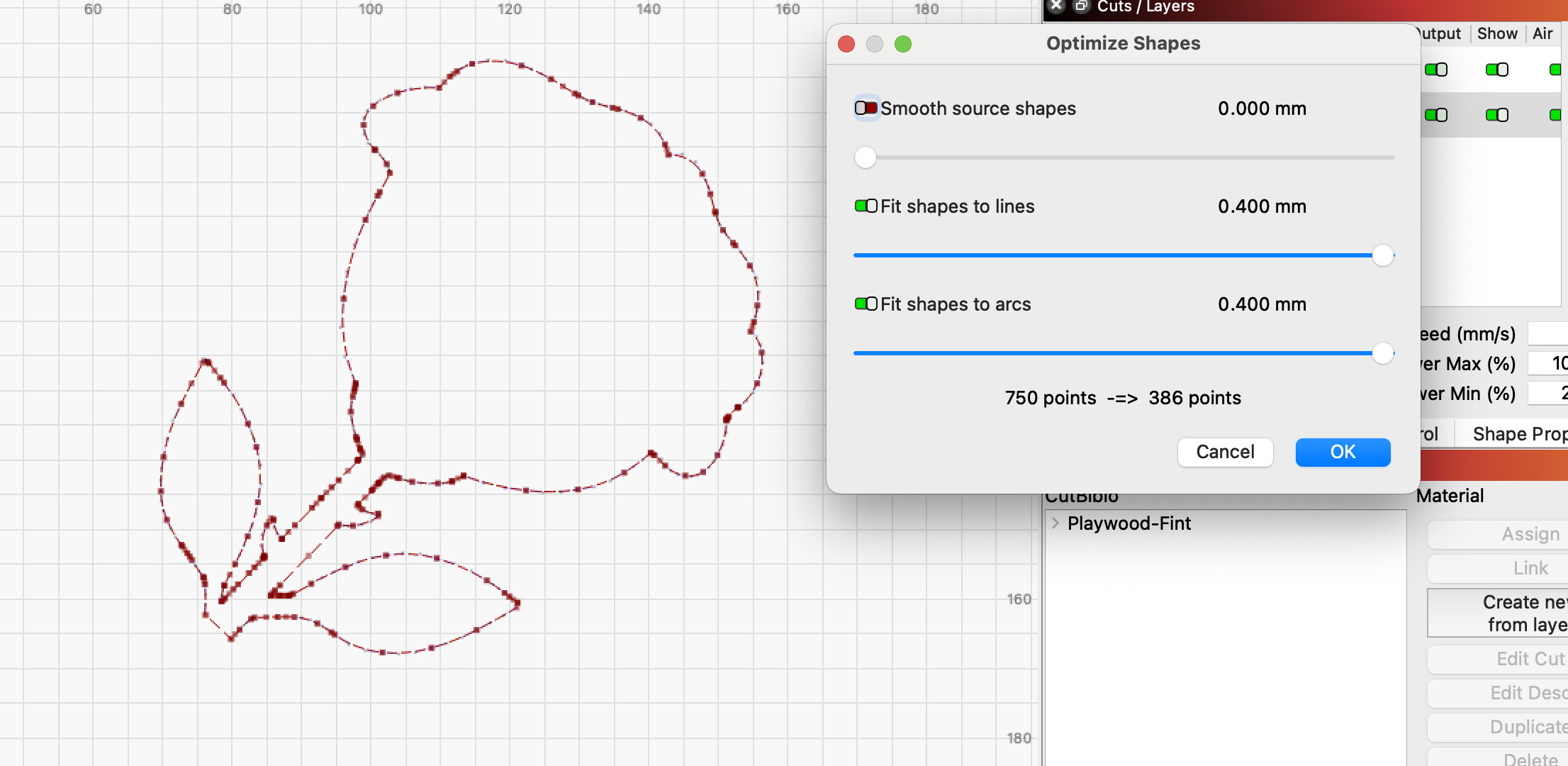

The first step (in my workflow, after the 2 basic functions) is that I simplify the shape. I do this to make it easier to “debug” and because fewer nodes require less work - :wink: see.image

Now I test again with “alt+cmd+o” - and the shape is still not closed.
From here it’s manual work, zoom in - a lot and find out what’s going on.

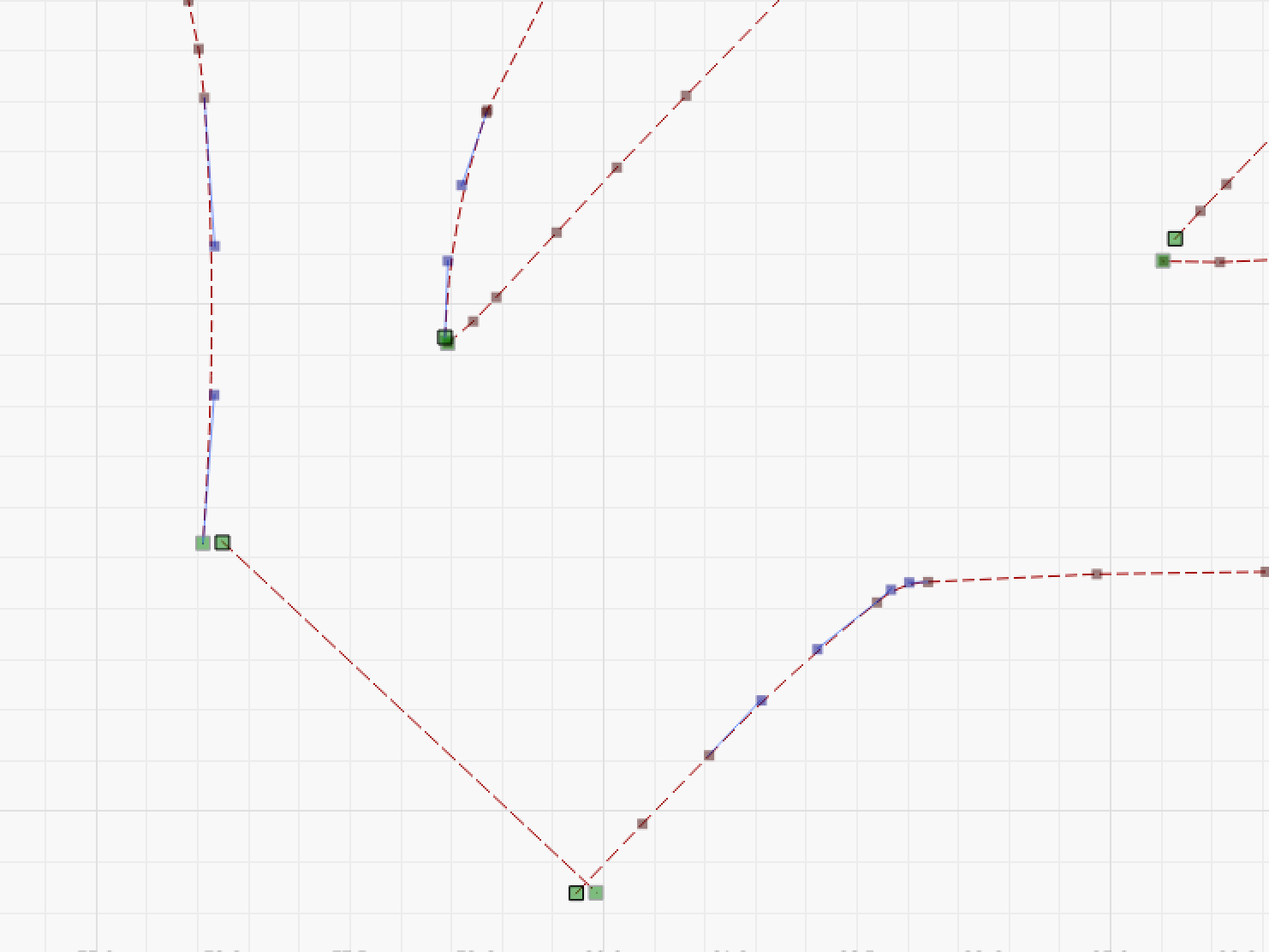

Just in the small piece that is in picture no. 2, there are the first 4 breaks of the shape, in total there are many, many. Actually, there was only a single break in the first file yesterday, so you must have worked this rose.
Try zooming all the way in, you’ll be surprised. A good indicator is all the green dots…There must be only one. When the fragments are too “complicated” or the nodes are too far apart, the automatic assembly does not work optimally or not at all, therefore I assemble the fragments manually. One green dot at a time until everything fits together correctly and there is only a single green dot left.
