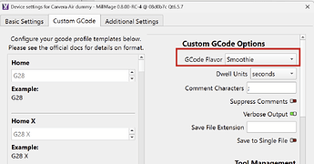

We have a couple of Carvera CNCs in the fleet, including the Air (still in the box). The firmware is Smoothieware-based, and there is already an option in the Device Settings for this:
There will be some extra changes needed for the Carvera Air to work and we welcome any feedback about it.

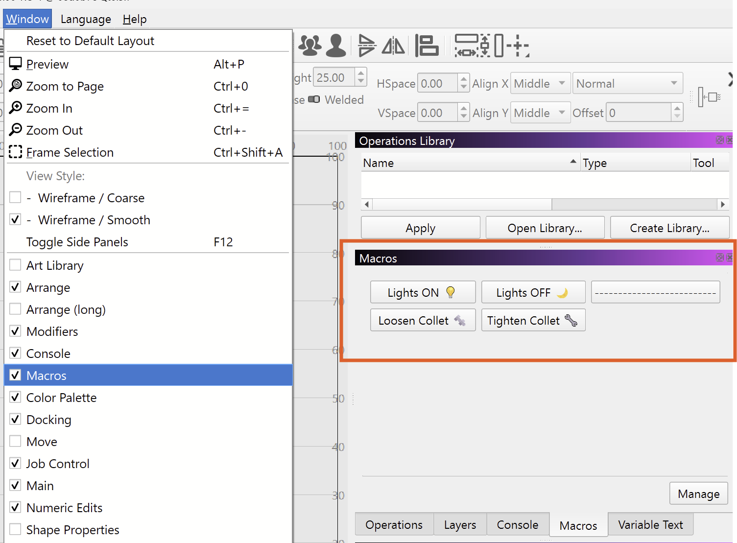

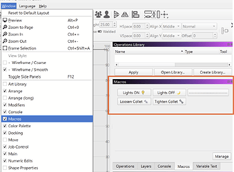

Carvera’s way of tool changing requires some extra Gcode blocks, which we don’t support yet.
In their list of supported G- and M-Codes, they list commands to loosen and tighten the spindle collet and control the lights.
I’ve added macros for these functions here:
Let us know what you discover!

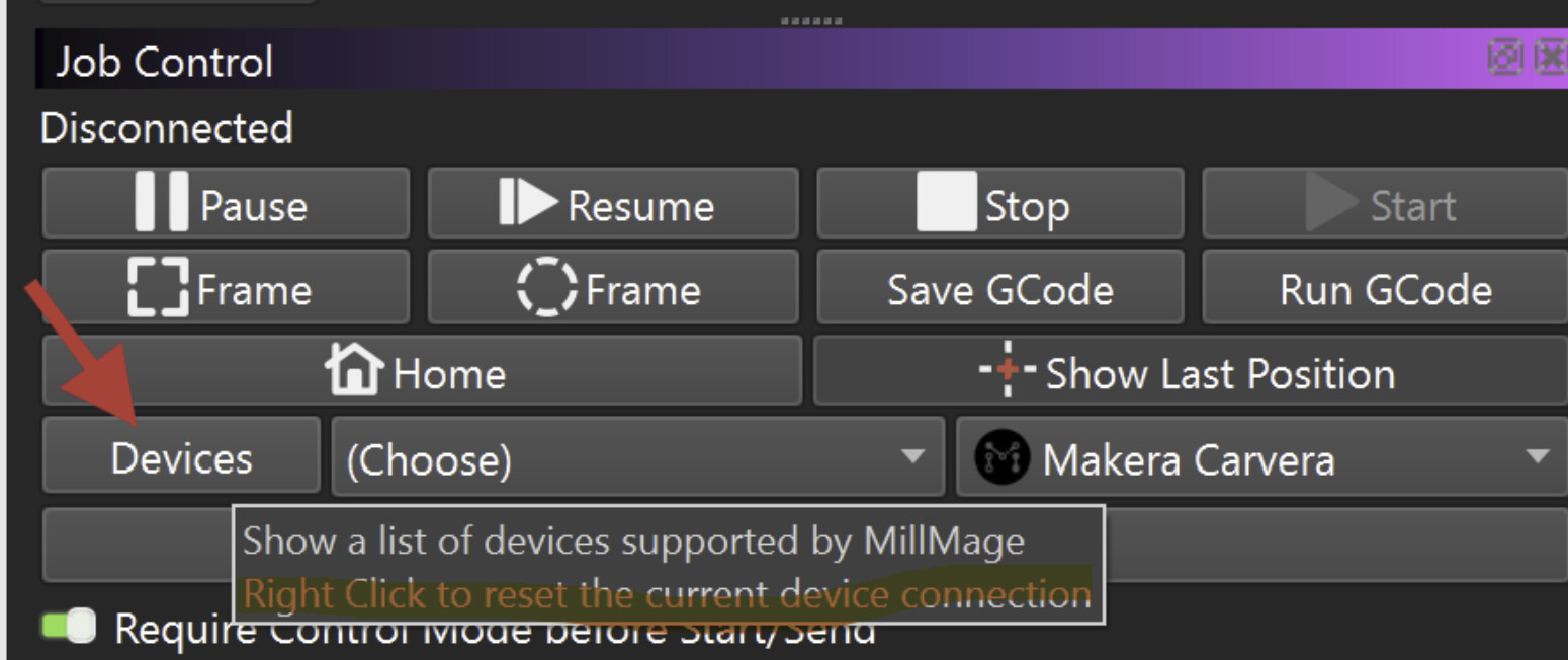

The Makera firmware version 0.9.8 has worked best for me so far. The only known issue so far is that after a “jogging” move, the controller does not always confirm correctly with “OK,” which causes MillMage to think that the machine is still busy.
Right-clicking on the “Devices” button in MillMage resets the current connection and is the necessary workaround at this time.

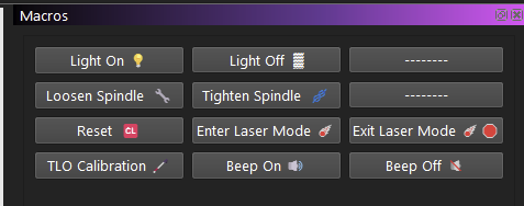

Feel free to use my initial settings for the Makera Carvera as a starting point:
Makera_Carvera_Initial_Settings_Aa.mmzip (15.4 KB)
You’ll need to adjust the machine size to fit the Carvera Air.
Use at your own risk :slight_smile:
I haven’t fully tested every macro, but “Light On / Off” and “Spindle Collet” already work, which is great!
