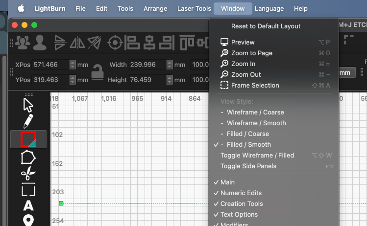

If you have a missing toolbar, you can reset the layout to default by going to Window>Reset to Default Layout in the top menu bar

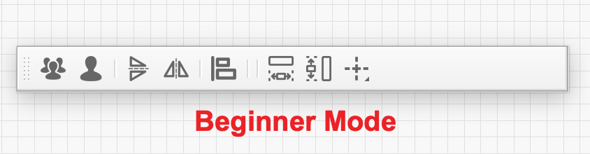

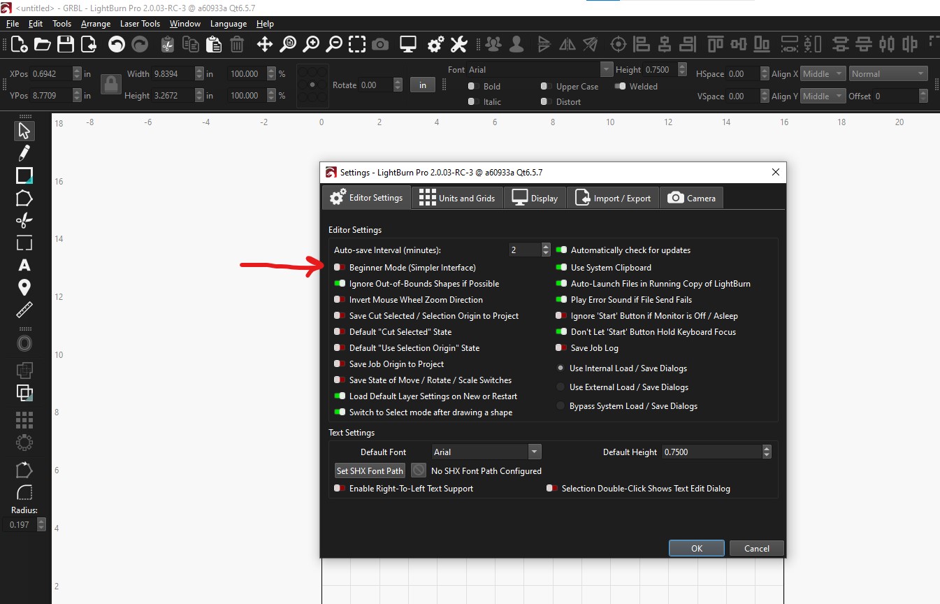

Worth verifying beginner mode’s off—could be affecting what you’re seeing

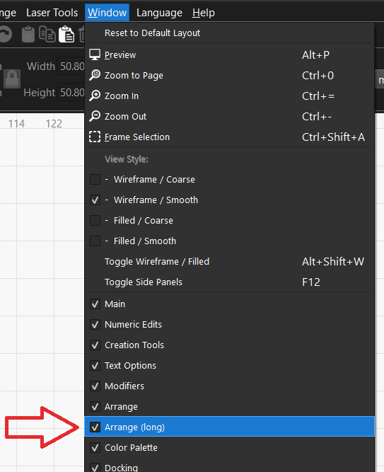

The toolbar will automatically shrink down if overloaded due to a lack of screen space. Try going to ‘Window’ and disabling a toolbar or two.

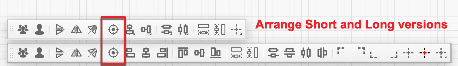

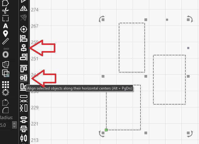

Center “tool” you may want to enable the “Arrange (long)” toolbar
Align objects along their horizontal/vertical centers
To support @Woodcraft’s comment, check to see if you are in Beginner Mode. :slight_smile: Below I show some examples of the change Beginner Mode makes to the UI.
