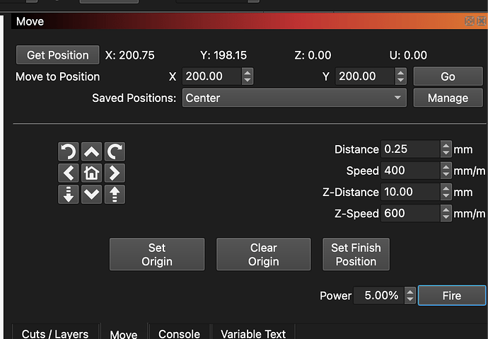

I created a wasteboard with a 390x390 grid on it. It was centered for many of my projects. Now, it is slightly off. I have searched through the forum and have either found the same question, but not answered or suggestions about tightening hardware, etc. As you can see, it is barely off center, but even after homing it remains slightly off. I really really don’t want to have to burn another wasteboard. Is there any way in Lightburn to adjust the workspace so that it represents the physical space? For example subtract 0.75mm off X and add 1.85MM to Y so that the Workspace center of 200X200 lines up with my physical space? Can’t seem to find in the forums about an adjustment like that.

UPDATE: I just spotted the positioning error in your second image. I am not sure if that would suggest a possible calibration issue. You told it 200mm, but the controller responded with 198.15 instead.
Home the machine and select Absolute Coords in the Laser window. If you enter G0 X10 Y100 S0 F1000 in the Console window, what does it report back for the finish position?
Update-2: Just realized your position readout is after You Jogged the laser to your center crosshairs. Is this true?

Once you jogged to your desired position, send G10 L20 P1 X200 Y200 in the console, followed by “$10=0”. Then you have set an offset for your workpiece that is now reported by the laser.

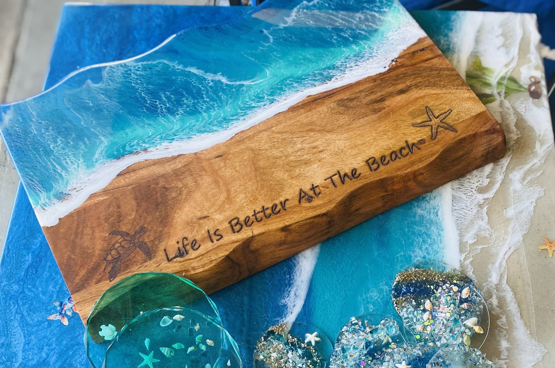

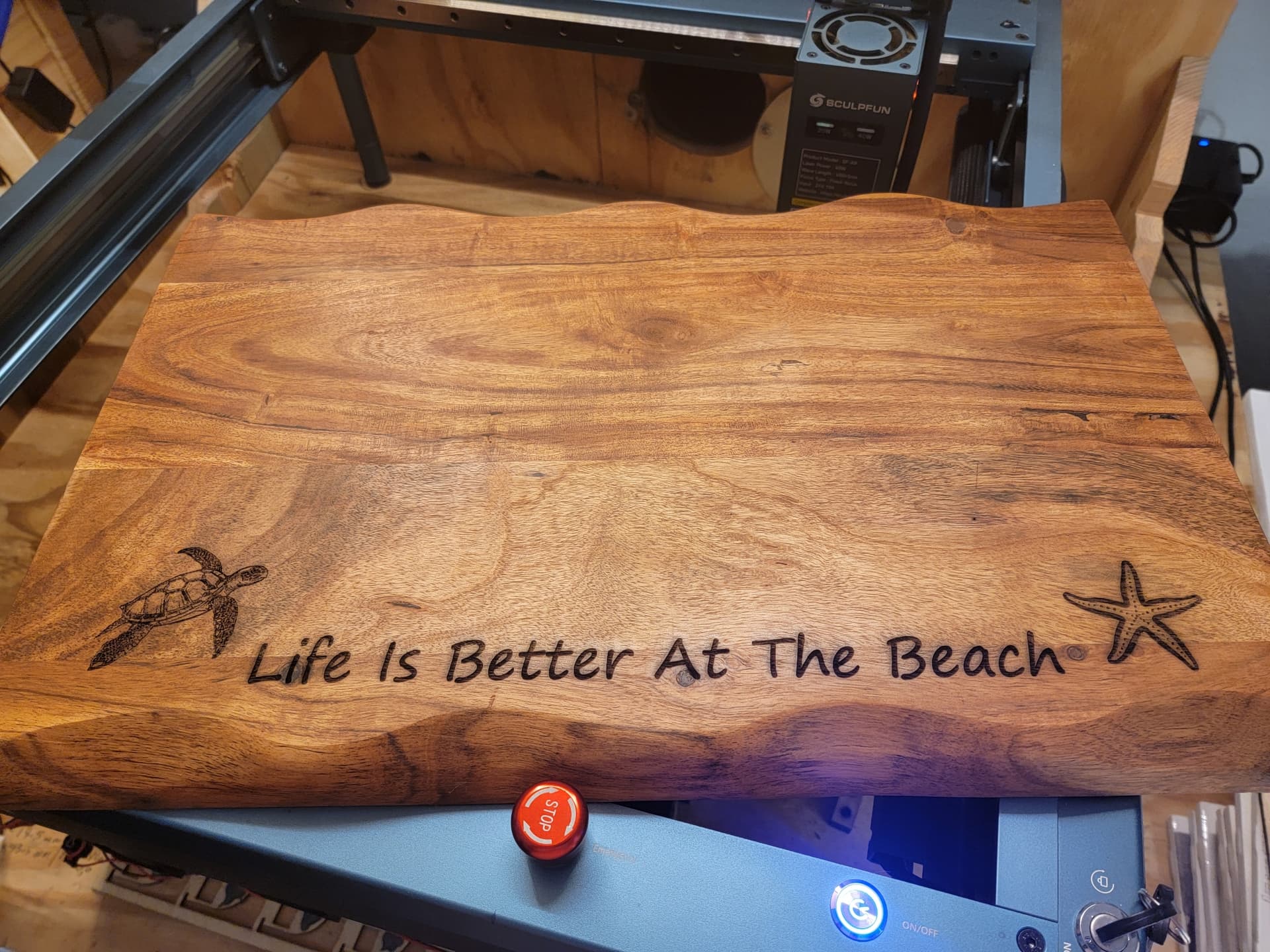

Beginning with laser engraving and that’s what I saw many tutorials recommend. The projects I am working on are all larger, non-repeated items- think 13" by 9" wood boards with different family names engraved across the center. This issue that this was causing was I mask my boards, offset cut the tape around the name, peel that section and then do an engrave on the name. The cut and engrave layers are grouped together so they “should” be lining up, but for some reason they were not. That’s when I noticed that my “center” of the wastboard and the center of the workspace were slightly off.

I do basically the same thing, except I skip the CA glue and painters tape. I just lay them on top of the honeycomb, fiddle with both the laser and drawing position using Framing, and have at it.
I usually apply the design after the board has resin applied because the flow is somewhat unpredictable. In this case, it was a rush job because I was leaving for NY.
This board was just about as large as I could handle without reworking my setup.
