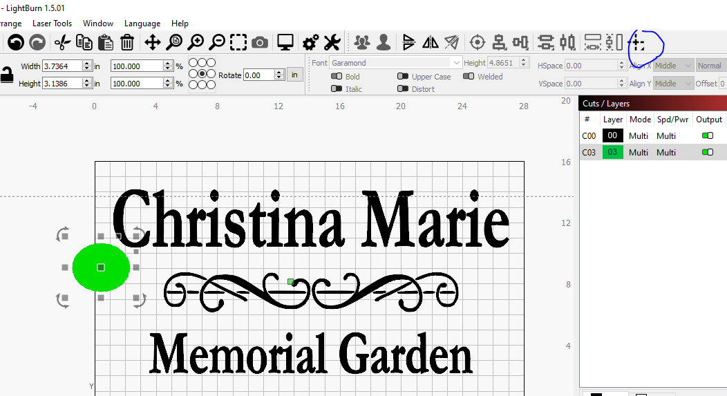

I set my size and create a shape, text, or image. I try to center it to the layout but it seems to be centering on my lower left hand corner. This did not happen until 1.5.01. Here is an example. If i try to center the green circle to the middle of this piece it centers to the lower left hand corner

I think you are choosing the wrong icon.

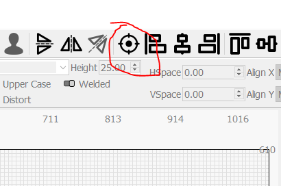

The circle with the cross hairs, does not work. I pick the item i want centerd and it doesnt not do anything …i am sure i am doing something wrong.
Your image layer is set to output but I’m betting you have the show turned off (because I’m not able to see from the first pic).
Your center is referencing both output layers.
Turn image output off and try again.
