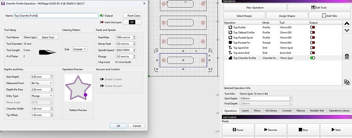

I’ve been trying to apply a Chamfer to an open profile (a single line actually). Doesn’t seem to matter what depths or offsets I apply it fails to produce a toolpath. Is it only setup to produce a toolpath on a closed shape?

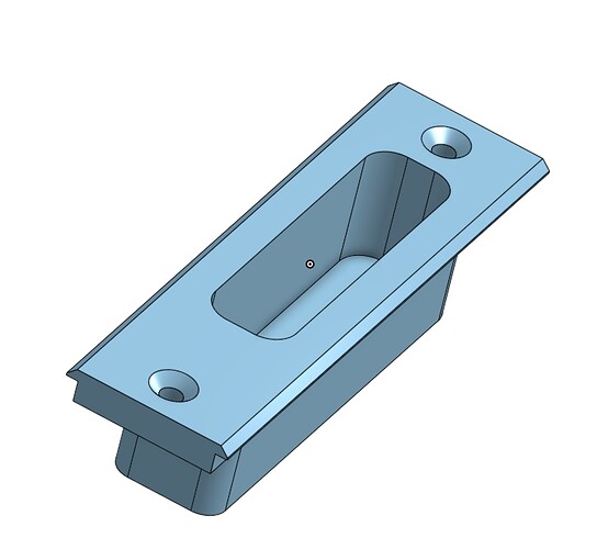

I’m wanting to chamfer the 2 sides shown on the pic.

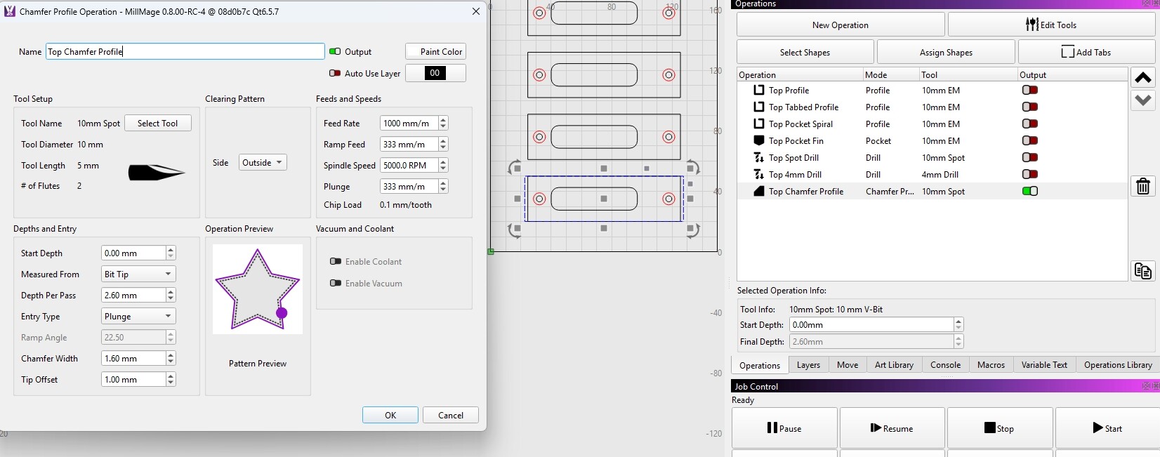

Ok, by creating a closed shape as advised above I get the chamfer profile to generate a toolpath, but it won’t “climb mill” on the outside. Inside is climb milling but not outside.
can you share the project file? and some screenshots of what you are seeing. This could certainly be a bug.
Right now though chamfer does need a closed shape to know which side of the line to land on.

I’ve attached the project file and 2 screenshots showing settings and preview path.

The “Chamfer” operation requires a closed shape because it offsets inward or outward, and a line or open shape has no “inward or outward”.
If you want to bevel on a line, just use a profile along the line with a V bit.
I hope to eventually allow you to offset “left or right” instead of inside/outside, but that’s not supported by the offset library we use and will require fairly complex custom code to support it.
