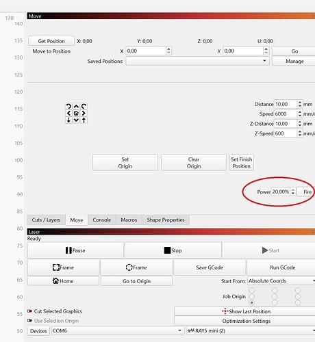

Change of laser power limit during testing currently max 20% (no more)
How to change this limit, currently max 20% and cannot be increased???
Welcom @max-bit .
That power is only for when you press the Fire button or when Framing, isn´t LightBurn Power limit.
For testing purposes check the Docs:
With your diode laser, an appropriate setting there would be 0.5% or even less (mine are all 0.25%).
But for some reasons (laser power measurement) I would like to have a special attachment with the ability to fully adjust the power from 0 to 100%
What you are looking for is a Material test.
