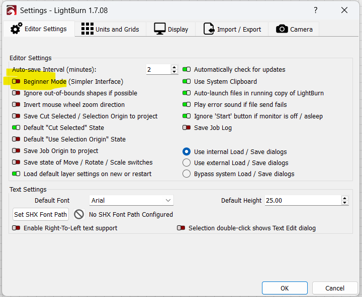

Hi, I have finally got my omtech 350 to do basic things and when trialling engraving settings I heve no way to change the scan angle .
On my home computer the cut and engravewindow has an option to change the scan angle but on my workshop computer The engrave window is different and has no scan angle adjustment. I note that I do not have a device set up on the home computer 9Just for design( but the workshop is set to the omtech 359.
Any ideas
Thanks

You’re in beginner mode in the second picture.
Thanks for the quick reply. Coming from a diode laser that was set up a long time ago I forgot about beginner mode. Thanks
