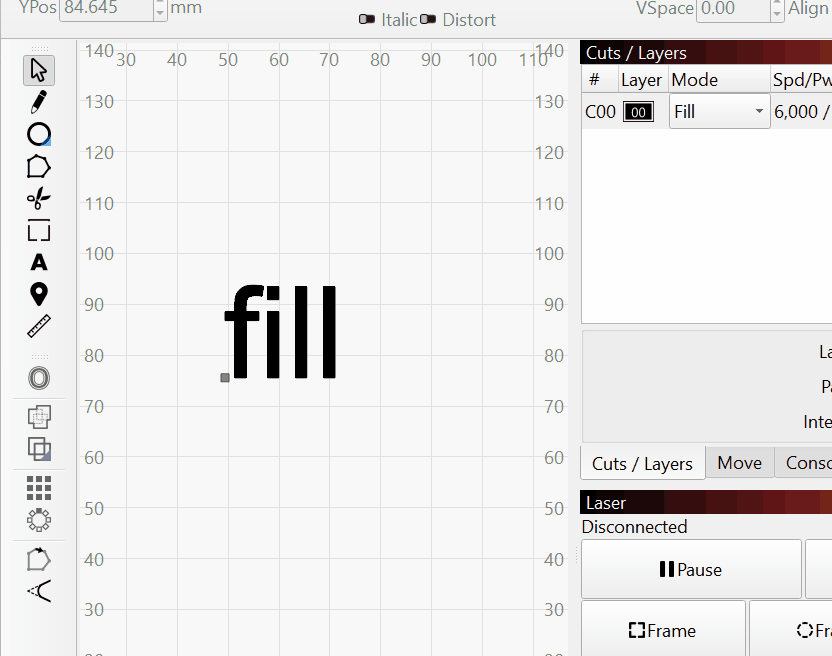

PIeI want to switch what it is engraving currently to what it is not. And of course what it is engraving to not engrave. I have an offset already for the cut line. I know this has to be the simplest thing. thank you
Depends on what your pattern is…
If an image, turn on Negative Image in the Cut Settings Editor.
If it is a CLOSED path and you are using the Fill mode, putting a boundary something like .001mm around it (using the Offset Shapes Tool) will “invert” everything inside that boundry.
Any closed shape, like a box, circle, or star, will do it.
If you are in Line mode, nope.
Show a picture of your current engrave using the Preview button (CTRL+P), or you could upload the file for us to look at.
Then we can give an absolute answer.
Hi @frizztees
I’m not sure if I’ve fully understood what you’re asking, but to invert a fill, you’ll need a closed bounding box.
InvtFill
Use some screenshots and more description to detail the issue you are having.

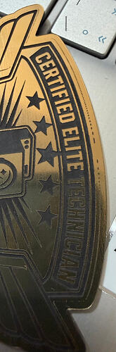

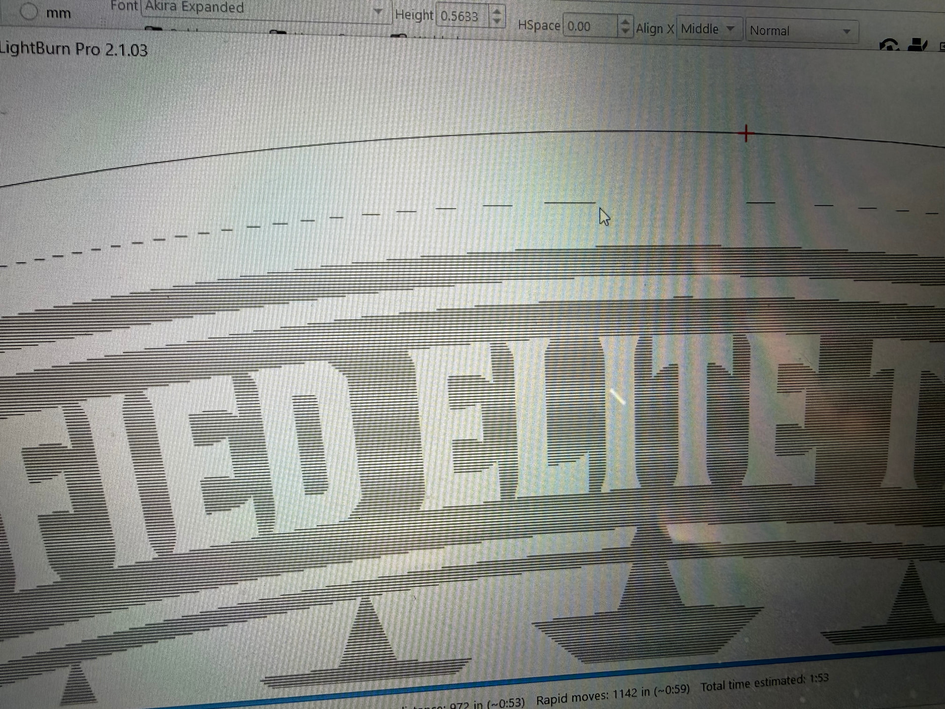

Thank you for your help. That did work but it did engrave that that extra line. you cab see in tge design and then the preview. That’s how it engraved those 2 lines close together like that

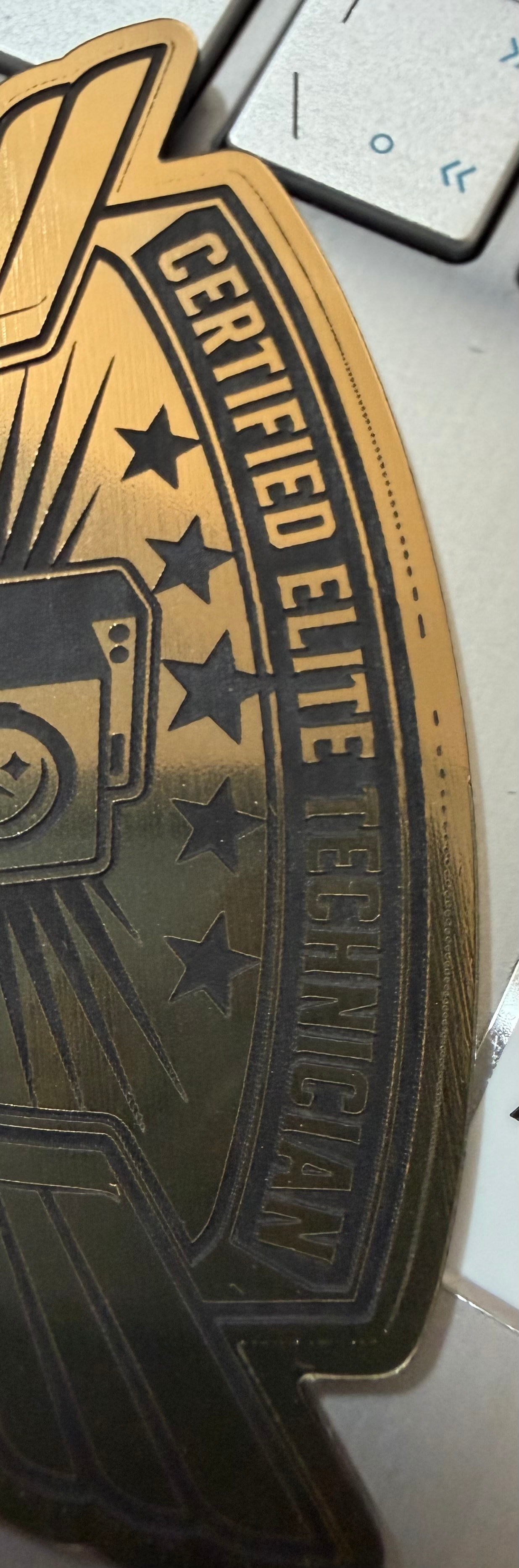

Thank you for your help. That did work but it did engrave that that extra line. you can see in the design and then the preview. That’s how it engraved those 2 lines close together like that
you can see how it engraves. very sparse and inconsistent all the way around. not sure why two lines would do that
Without seeing the [1] entire object, [2] knowing what material, [3] and [3] what speed and power settings used, it will be difficult to diagnose.
This is a different subject and should have been another Thread (topic). This also relates to a CO2 laser and Ruida, neither of which I have. I must let someone else jump in and diagnose this part. Thank you for letting me know what I posted helped you.

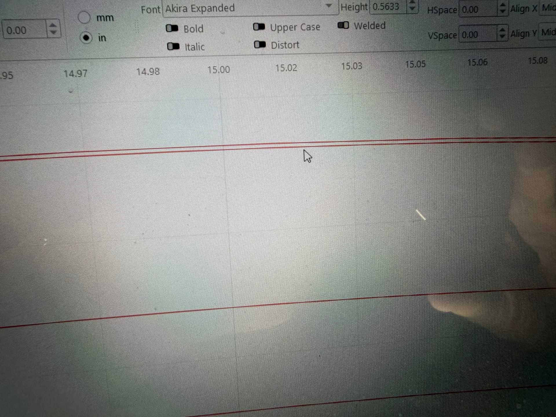

You are able to use a .000 offset distance to get the same inversion effect - no need to add distance (even tiny distances).
FWIW, IMHO and ipso facto :smiley:
Yes. I know, but then try to separate them later! Been there, done that. :roll_eyes:
