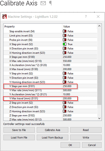

I have built myself a first draft of an InLay conveyor for my 50w Blue China Laser with 300x500mm and the Ruida RDC6442S-B-EC controller, which should allow to process “n” x 500 mm.
I am using Lightburn version 1.2.01. The function of the conveyor seems to be designed only for repeat jobs with Max 300x 500mm.
As i understood, the maximum travel is defined in the controller in the Vendor Settings. (300x500mm)
I assume that the configuration of a new laser in Lightburn will not be able to bypass the vendor settings in the controller.
So i will probably have to change the vendor settings regularly when using the inlay.
Question:
Is Lightburn in 1.2.01 able to “safely” edit the vendor settings or should I use the vendor software RDWorks to be on the safe side?

Hi Andre, could you not use the, working size in device settings and adjust from there each time?
Hi Kris,
Unfortunately, this does not work.
I get the error by machine at start-up: “Frame slop
Work paused”
Or when I want to run a frame: “Y Slop over”.
The reason must be that it is written hard in the controller.
And leaving it permanently with larger config in controller is too dangerous for me, as I only have one x and one y limit switch.
Hi, sorry didn’t mean to use the size in the picture, they’re just the settings for mine.
The memory question, If you mean, ok to overwrite a file on the laser rather than delete or rename, I do it all the time if I don’t need to reuse the file.
Now and then, i’ll format the memory, just to clean it out.
I have the OMTech 80w, so similar to yours.
I’ve adjusted vendor settings myself but wouldn’t recommend it unless you do some reading up on it, easy to change and easy to screw up.
Hi again, if you go into DOCS at the top of here and search ‘machine settings’ it explains a bit about it there.
If you are going to change anything, click ‘save to file’ first, open a new folder, and it saves everything before any changes.

It’s not ‘calibrate axis’.
Not at my laser so i can’t check but I believe, if you scroll down to ‘vendor settings’ that’s where you’ll find ‘x’ axis ‘travel’ and ‘y’ axis ‘travel’.
When you change those, click ‘write’, it then sends it to the controller.
Before you change anything, click ‘save to file’, it will want you to make a new file, it will save the original files so you can put them back to default when you want.
