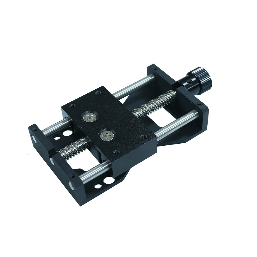

I bought the quick adjustment for the laser master pro 2, and it told me I needed to adjust the x-axis maximum speed. I cannot find it in the lightburn software.
Is this what you bought?
Where did you see that you needed to change x-axis maximum speed? Can you show specific language? Was a value indicated?
