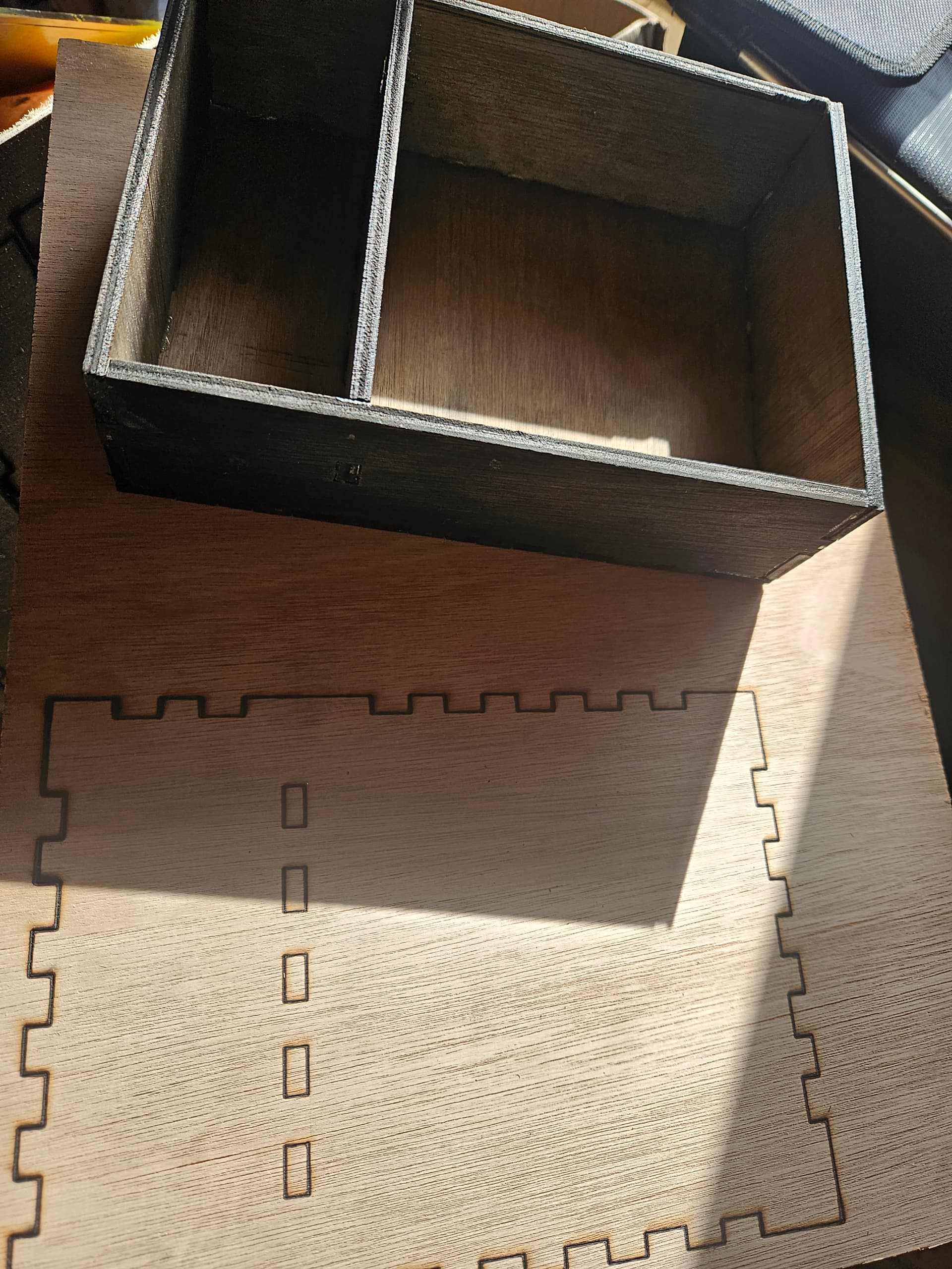

I had been succesfully cutting 5.5mm plywood to create boxes.
I must have got 120 of these made before changing the lens. I should have had air assist but felt I was geting away with not having it, until 3 passes had stopped cutting through my ply boards, I changed the lens.hoping this might fix it, but if anything the cut is weaker than before.

Maybe some pictures of laser and lens etc. Cleaning/changing lens should have taken care of the problem.
Also look at pattern on the wall.

Looking at the picture odf the cut…your Focal length may be wrong..
Noticing the ‘cut lines’ are wide not a nice tight line…
Do a focal length ramp test to determine the best height off the material
to cut at… ( as I am sure you have done before)
When I,change lens, I always need to adjust even if it is the same type..
no two are exact… close maybe …

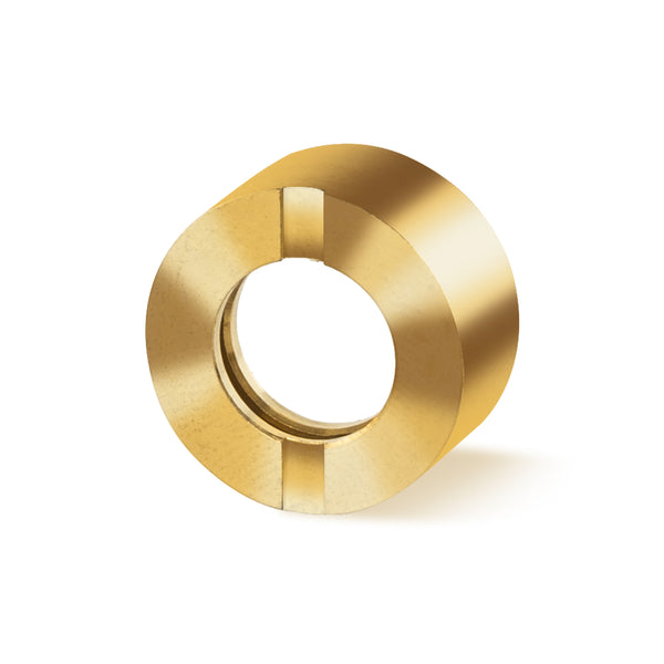

With the foxalien module, I can only chabge the very outer lens. That comes in a brass housing.
So you simply unscrew the old one and screw the new one in place.
Perhaps I can buy just the lens and keep the brass housing next time.
In fact, as I look at this outer lens, or look through it it doesn’t seem to bend/refract light nuch, if any. Perhaps the focus of the beam happens higher up inside the laser module and this ‘lens’ is more of an end cap.
Or maybe the tolerances are so small that wgat looks to my eyes as a plain piece of glass, is actually doing just enough to the laser to focus it.
Anyway, short answer is that you can’t screw the lens on a fox alien module the wring way. Even I can’t get that wrong pal.

It’s more protective than an actual lens. I just clean mine with alcohol unless it becomes damaged. I use air assist on everything I do. Less for engraving and more for cuts. Keeps smoke from backing up into the lens.
