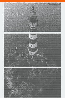

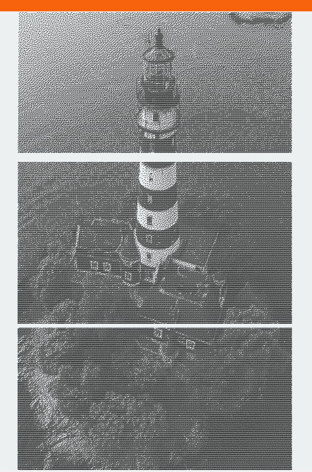

You can also use the Cut Shapes tool.
Works with vector and images.
With this tool you’ll get parts that when joined are exactly your original image.
Sorry was on mobile.

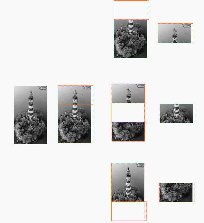

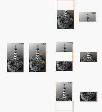

Here is an example:
Just draw the shapes.
Place the shapes against each other.
Select the shapes and the image and duplicate 3 times.
Separate all the 4 sets and put one aside as a design backup.
1st part - First set - Select image and first shape then Cut Shapes Tool - drag cut aside.
2nd part - Second set - Select image and second shape then Cut Shapes Tool - drag cut aside.
3rd part - Third set - Select image and third shape then Cut Shapes Tool - drag cut aside.
And a preview of the parts:
