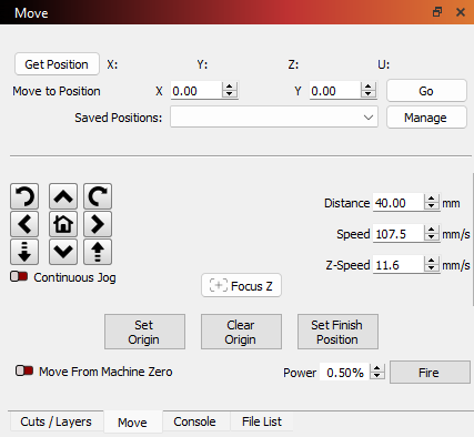

The machine must home into the corner with the home switches, because that’s how the controller knows where the origin is.
Reset everything you changed so the machine homes correctly into the corner with the switches.
If you want the laser head positioned elsewhere at any time, store that position in the Move window, then send the head there:
The Set Finish Position button lets you pick where the laser head will go after the job finishes, so it will automagically get out of the way.
I made a “Retract” macro that moves the laser module out of the way. Not getting any errors with this method either.

I am not sure what that is, could you please expand a little on this?
A Macro is a segment of code that runs when you click on the button. In this case, it would be some GCode that tells the laser where to move to. If you have more than one machine, the Macro follows the selected Device, meaning each machine will have its own set of Macros.
You can research GCode programming, but this will get you started. This will tell it to move at the maximum rate of the laser:
G0 X350 Y350
Of course, you will have to adjust the X and Y positions to suit your needs and machine size.
