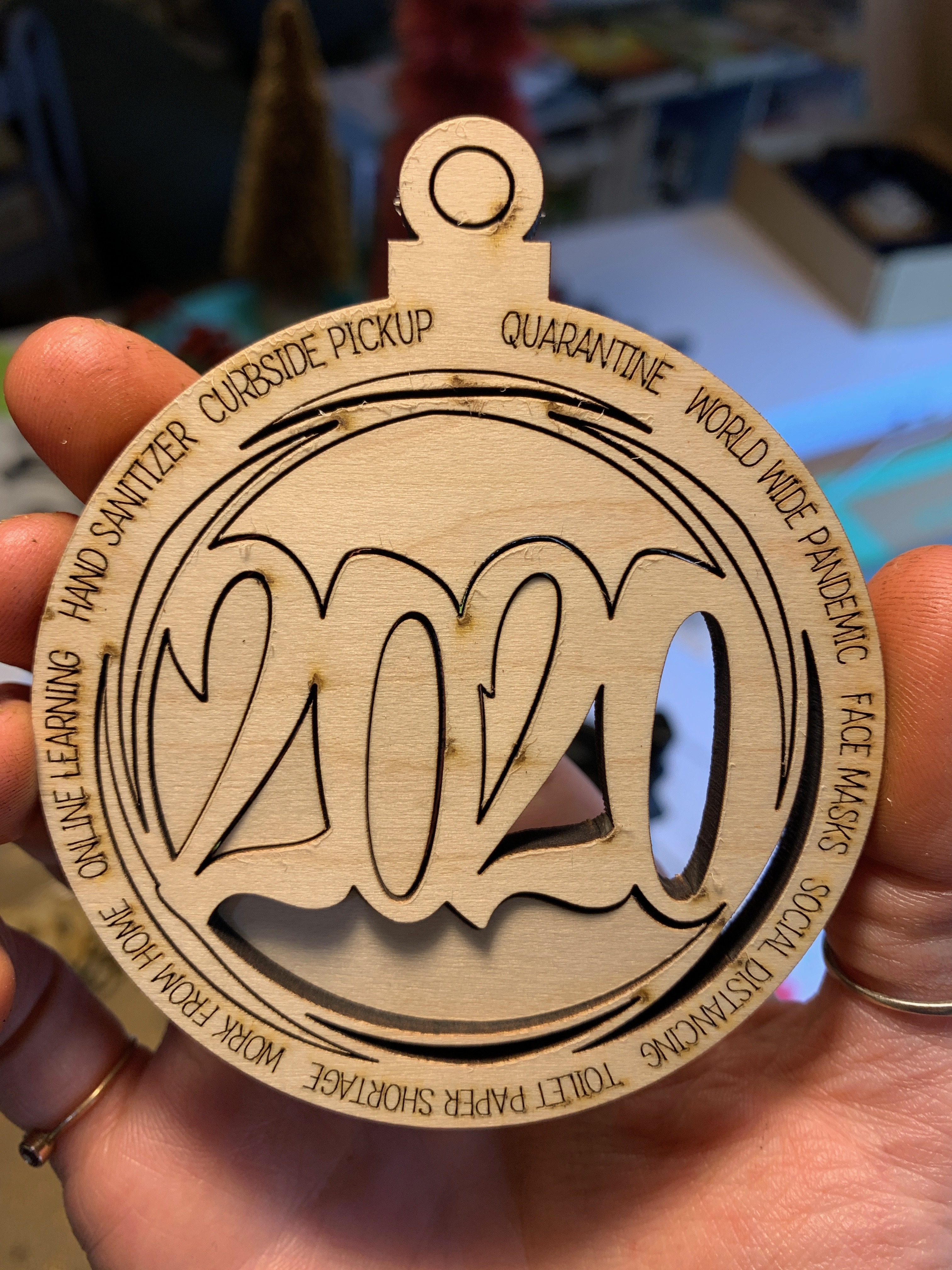

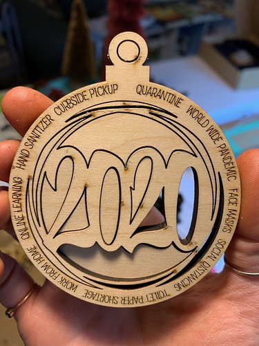

Hi!
Question from a newbie. I am trying to perfect my cut on this ornament, and when I look at it I can see that all the burn marks show up on the ornament. (the spots where the laser started/ended each of these cuts). Is there a way to do something with the nodes so that the burn marks where it starts/stops end up on the chads/pieces that are discard? I tried playing with the offset/inset, but that just made the charring worse. My theory is it did that b/c the laser just ended up concentrated in that general are of the cut for longer (130 watt laser) so it ended up creating more damage instead of helping.
If the only solution here is to use the inset/offset, can I specify which side of the cut it leads in from or does the software algorithms always choose that?
Thank you!
It looks pretty thick your material, can you mirror the ornament itself and burn it from the back ?. You will of course get an extra workflow but if the result gets better it is worth it.
On the other hand, I think your result is fine enough considering the thickness and you need to sand the surface a bit anyway.
Thank you for the ideas. I hadn’t thought of sanding after. I prefinish two coats of varnish then lightly wipe off the residue. Which isn’t working too well b/c to get the char off I am removing the finish. But I really like pre-finishing from a time saving perspective. I suppose if I put the honeycomb in I could lay the whole sheet down, cut, flip them in place, and then engrave to finish them. (sounds like a bit more work though! :stuck_out_tongue: ) - hoping somewhere in the advanced settings is a way to dial in where the cut is angling from , or is there a way to have it start at much lower power? I know that there is a min/max power but think that just applies when it slows down the lower power kicks in? Hmmmmm. So many questions!!!
The char is ejected smoke coming out the front before the cut has gone through the wood. The laser fires and begins to move along the cut, and for just a moment it hasn’t gone through yet, but it has made a short trench behind it, and the smoke ejects that way until it punches through.
The only way to steer it where you want it would be careful use of ‘Lead in’, so the leads were always placed in the offcut. Light sanding, or a bit of alcohol on a cloth will remove the soot easily.

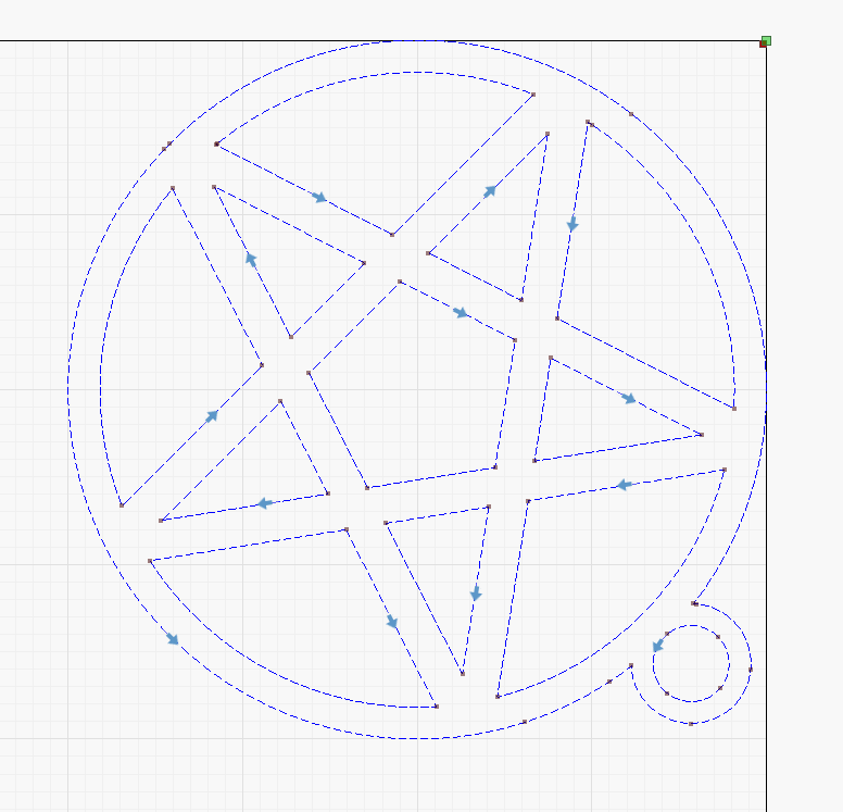

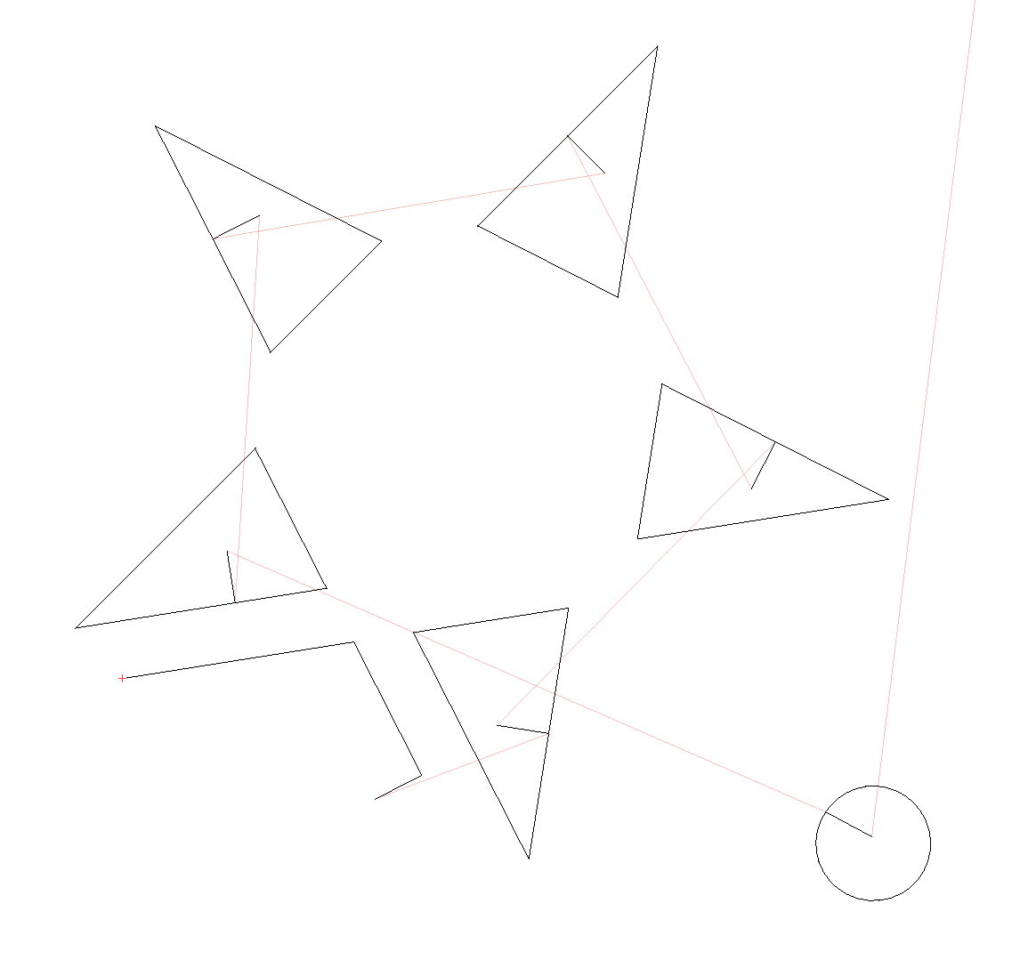

Hi,
as you can see in attached pictures, the cut is going wrong direction against the definition.
There are no any overlapping lines.
The source lbrn is there: pentagram.lbrn (35.1 KB)
I see I have “choose the best direction” optimization on, butthis should apply only for “automatic chosen” starting points (grey arrows), not for the manually managed (blue ones). Am I right?
You’re right, it’s supposed to respect it. There was one spot that wasn’t checking for the forced start / direction, and that is in the ‘Reduce Direction Changes’ code - if you turn off that optimization it will keep your start direction. I’ve fixed the bug for the next release.
