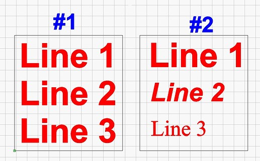

Is there a way that I am unaware of to change a singe line of text within a multi line text box without breaking it into separate text blocks?
What I trying to do is change the text in Box #1 to something similar to Box #2
Vers 2.0.05 and 2.1.03
short answer - no
That’s really sad, I was afraid that was going to be the answer.
Just another of many reasons why there are better programs than LB to design in.
I can’t follow your problem.
If you only have 3 (or more) lines, write and format them one line at a time and make a kind of template, you can even use “Variable Text” on the lines and group the whole block afterwards…

You’re right, LB started out as a laser control program, and it does excel in that. But if LB is going to have a text editing window it should have the ability to change attributes to different parts of the text. This should be fundamental.
Over 40 years ago, on a Commodore 64 running geoWrite, (a 64k machine with only 32k available for programs to run), I was able to edit different parts of text with different attributes. Why can’t LB?

I do all my design work on a professional vinyl sign program where I created a color library using the colors LB published for their palette. In LB I have the different colors set as default to do different things, such cut at a different speed and/or power for different materials or different setting to do different types of engraving. So when I export a file, then import to LB, all the layers with settings are in place all I need to do is run the laser.
In this case I needed to change something I thought would look better on one line of text, that’s when I found the problem in LB. I made change in the design software then brought it back to LB before I posted here.

Yes, Ron there is. Open a word document in windows and type the lines you want. Make a text box in words and enter the lines you want. In words there are over 220 fonts to choose from. Save the document as a PDF file, then import it into LB.
Done That, Did That
