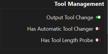

Hey, the guy who wrote the tool change logic in MillMage here… let me try to explain a few things.
We have 3 tool changing options, seen below:
And I know this will still be a little confusing. There are a lot of permutations of how this *can* work and we’ve tried to cover most of them.
If `Output Tool Change` is *off*, we won’t even output any of the code in the `Tool Change` block. We assume in this mode that you have no tool changer and that you will be exporting the operations for each tool separately either using the operation output toggles or the export wizard (Which allows you to automatically split file by tool).
If `Output Tool Change` is *on* but the other options are off, we will emit the `Tool Change` block if the selected tool is different at all, even if the tool index is the same.
However, `Output Tool Change` without `Has Tool Length Probe` is a tricky situation: this assumes that your tool changes are manual but that all of your tools are the same length. Because there WILL NOT be any way for you to probe Z after the tool change without splitting up the job.
But, if you also have a tool length probe: In this state we assume that your `Tool Change` block is a manual tool macro.
First, please note that this is currently only supported on GRBL machines.
Also, the note from support that this will default to the `!` pause command is wrong. You must configure this yourself and you cannot use the `!` pause command, as we have our own pause function for this, see below.

If you have `Has tool length probe` checked it will then also run your tool length probe macro automatically. Again, if you DO NOT have a tool length probe you should probably not be using tool changes in this way.
If you have `Has Automatic Tool Changer` selected it will output the `Tool Change` block only if the tool index is different! In this case we are assuming your `Tool Change` block is something simple like:
`T{tool_num}`
and that the controller handles the rest.
At this time we do not support the ability to program complete tool change macros inside of MillMage. As in the ability all the movement logic for getting and picking up a tool is in MillMage instead of the controller. This will be coming at a later date.
I expect 95%+ of our early users to need all 3 of those options off and will be doing tool changes manually but require running each job as separate parts, per tool.
