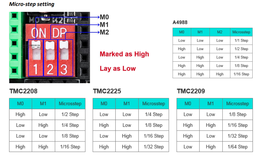

hello, I’m not happy with my laser.
the first thing is that I have an elkmaker frame with the factory stepper motors, I think they are no 17 motors.
The main bordom makerbase DlC 32 V2.1
The motor driver is TC2209
My problem is that the X mount just shakes when I use any device. when I try to move it, it just shakes and tries to move in one direction
Y1 and Y2 don’t move even if I do anything with it.
I tried replacing the cables of the motors, then the x axis moves smoothly, but the Y axis do not move in one direction either.
Can someone help me to solve this problem?

Can you provide the wiring diagram your using and a picture of the steeper motor drive config. switch positions?
Try putting X axis TMC2209 in Y axis and test.

if I attach the x driver to the y axis, the y axes move but only in one direction and the x axis does not move
Sounds like driver issue.
how can i check this
currently, the Y axes still only move in one direction when the + and - buttons are pressed.
The X axis does not move, only a soft click sounds from the motor
