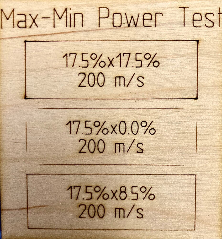

I always set min power for cutting and leave both the same for engraving. Min power allows the laser to reduce on slow down so you don’t get overburn on the corners / direction changes. Engraving uses a side to side scan and it doesn’t slow down during the scan, it uses overscan, where it goes past the design to change direction, allowing full speed for the entire engraving.
You have to experiment to get the setting for your machine. On my 100W, I typically use a min of 8.5%. On some materials I have it as low as 7.5% or as high as 12%. It all depends on the material you’re cutting.

Here is a visualization of what min power is (also) used for.
