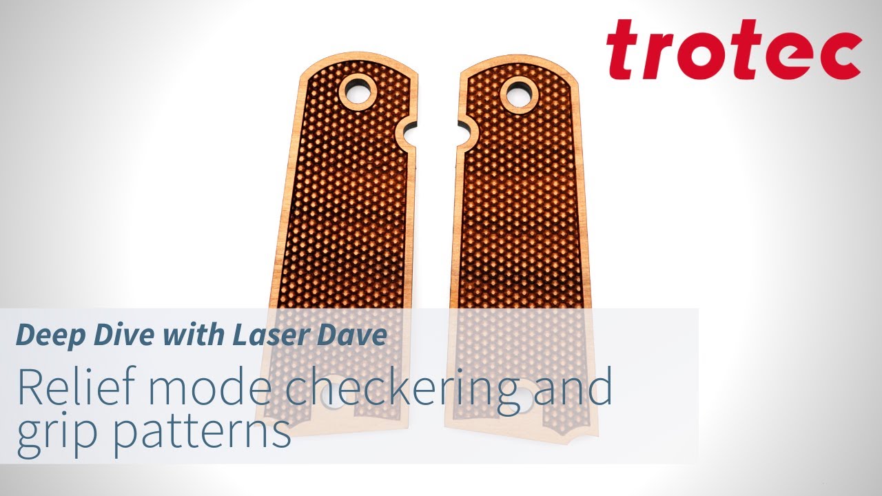

A more powerful laser… but this is pretty cool:
Hand checkering is common in the custom world of gunsmiths for sure. Lots of file work and layout lines.
This is precisely the type of effect I was referring to with a CO2 laser. Nice that you found a video specific to your application.
